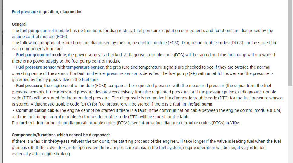

Car won't start when warm nor first thing when its warm outside. Have replaced fuel pump, fuel relay, coolant temperature sensor and cleaned the MAF. Also replaced pcv. Now think its the FPR but can't locate it. It is not on or under the injector rail, or near the steering. Don't know if its a mechanical FPR or electronic. Could it be on the fuel tank?

Your engine does not have a separate fuel pressure regulator, it is part of the engine control module. Basically it monitors and regulates the fuel pressure and then will set a code if there is an issue.
If you have no codes then I would just check the fuel pressure when this is acting up and find out if that is the issue.
