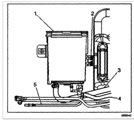

Where is the fuel filter located I need to replace it?
2008 PONTIAC MONTANA
128,000 MILES • 6 CYL • 2WD • AUTOMATIC
ABBROWN43

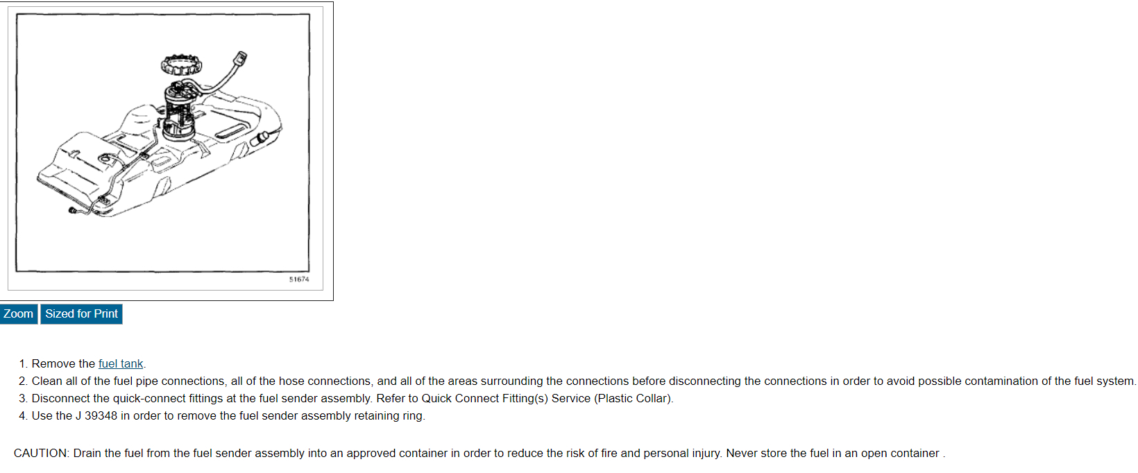

My van was running fine until yesterday, it stalled out at a red light seems to not be getting fuel. The fuel pump is working fine. Just can't locate the fuel filter.
Feb 5, 2020 at 9:58 AM
  • 55,447 POSTS

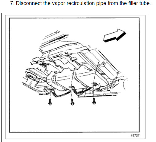

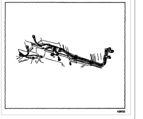

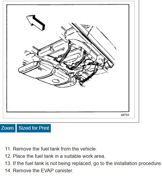

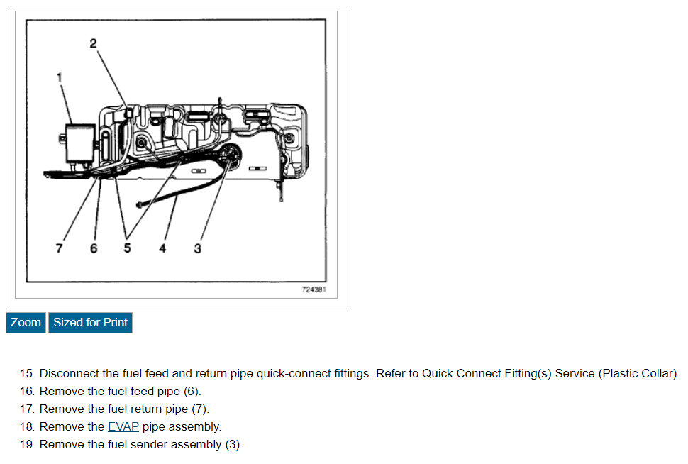

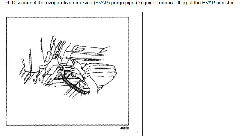

Here is a guide to help walk you through the repairs with diagrams below to show you how on your car:
https://www.2carpros.com/articles/how-to-change-a-fuel-filter

A dirty fuel filter has no connection at all with the gauges. The fuel sending unit is what controls the gauge and it is located in the fuel tank and requires no regular maintenance.
Your fuel filter is located about 18" to the front end of the fuel tank on the inside of the frame
