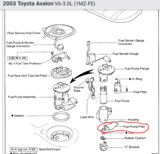

Fuel filter location
2003 TOYOTA AVALON
100,000 MILES • 3.0L • 6 CYL • 2WD • AUTOMATIC
HK667429
I can't find the fuel filter.

Your fuel filter is non-serviceable.It is a part of the in-tank fuel pump assembly.It can only be changed in case of an in-tank fuel pump replacement. I've attached a picture below of it's location.Hope this helps and thanks for using 2CarPros.

Hi Danny , thanks a lot for your help. It is really very useful for me . I spent several hours to look for the filter. Once again thank you .
