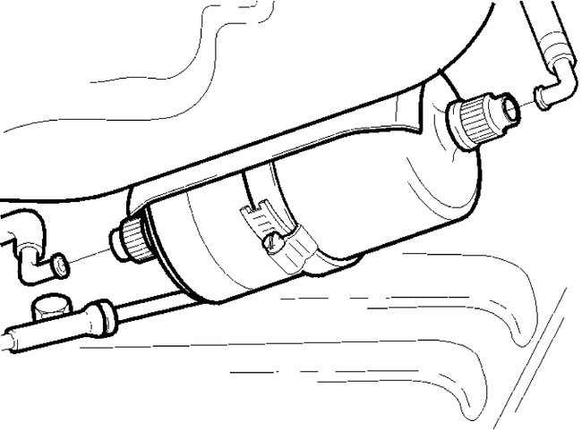

Car is sluggish to start. Fuel filter is original. Battery okay. Alternator okay.
Is is possible to change the filter (if it is underneath the car) without a lift?
Dec 25, 2018 at 11:26 PM
  • 110,240 POSTS
It's going to be tight if you don't lift the car. The filter is located near the driver's side rear wheel. It will be along the frame.
Here is a link that shows in general how one is replaced:
https://www.2carpros.com/articles/how-to-change-a-fuel-filter

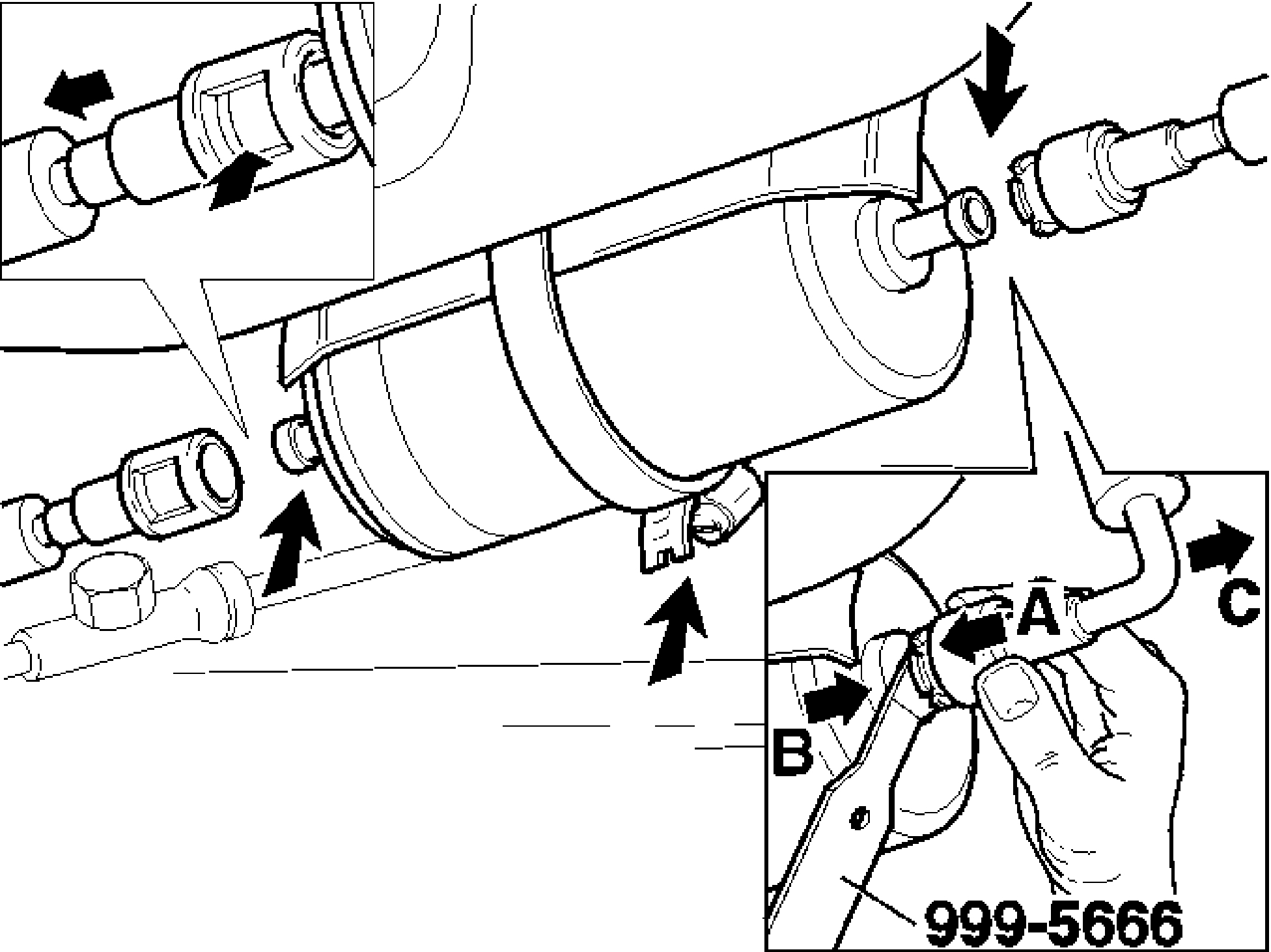

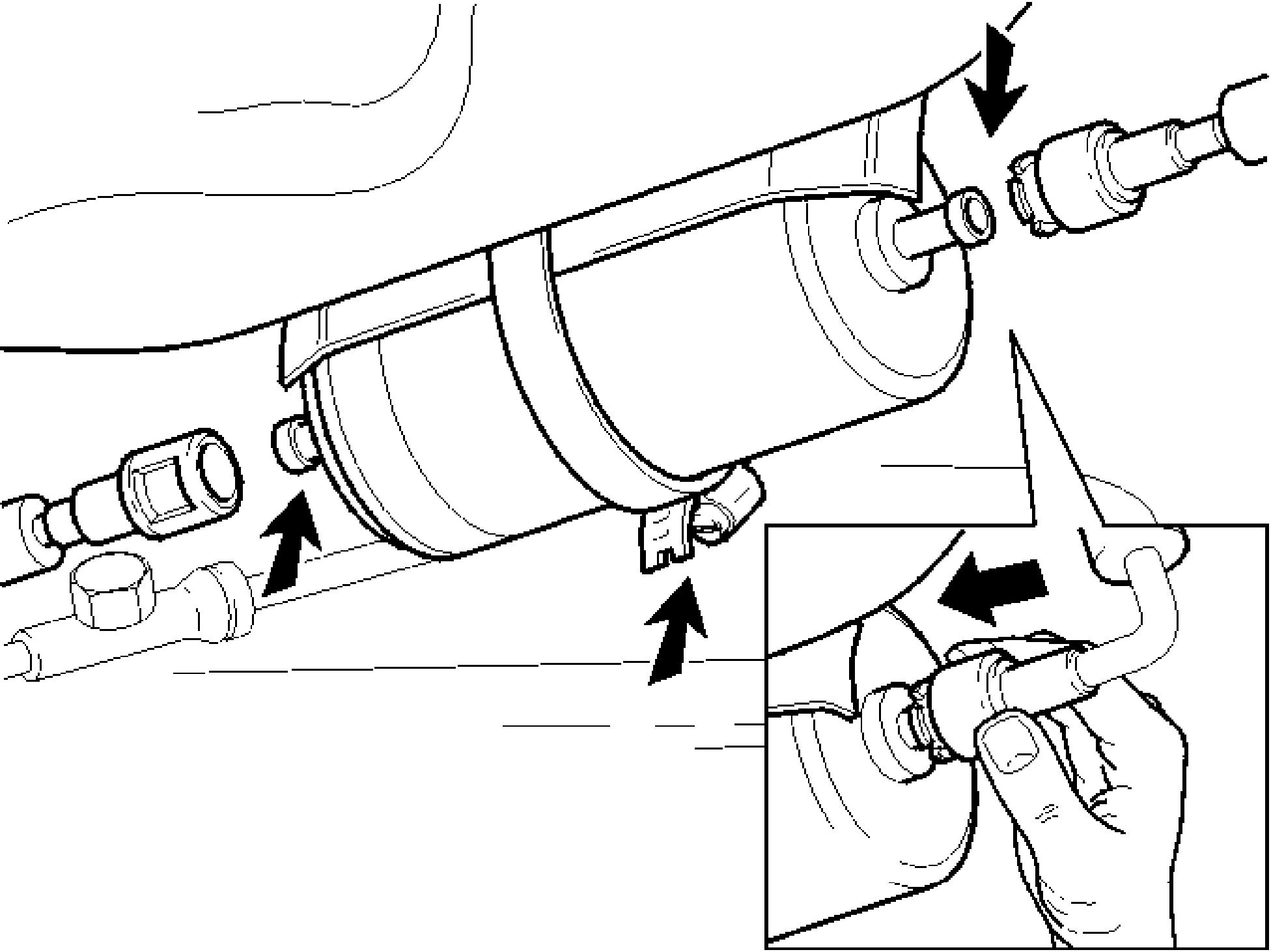

Here are the directions specific to replacement for your vehicle. The attached pictures correlate with these directions.
________________
REPLACING FUEL FILTER
Replacing Fuel Filter
Special Tools: 999 5666
Draining fuel system
- Drain fuel system according to Draining the fuel injection system.
Removing fuel filter
Front side:
Carefully release the quick-release connectors by pressing the fuel lines towards the filter (A) while moving the black circlip backwards (B), together with the fuel line. Use tool 999 5666.
Rear side:
Press the fuel line locking part in and pull the fuel line off.
Remove the clamp and remove the fuel filter.
Installing fuel filter
Install the new filter and carefully reconnect fuel hoses. Check that the quick-release connectors are secure by pulling them.
Secure filter on the bracket with the clamp.
Start the engine and check for leakage.
