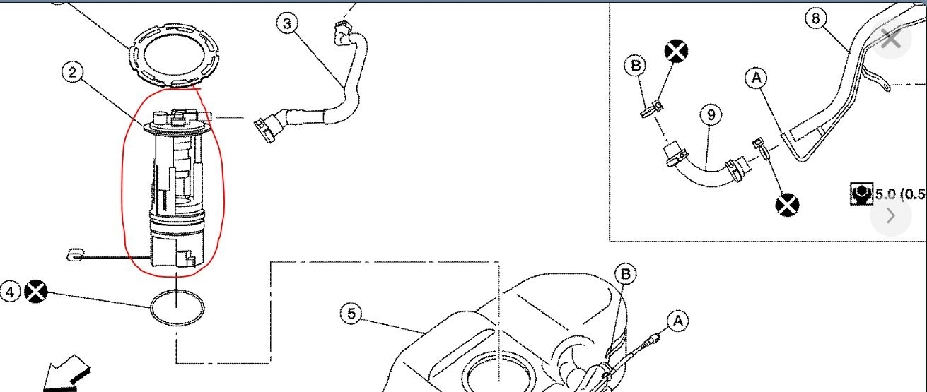

Where is the fuel filter located
2013 NISSAN FRONTIER
85,000 MILES • 6 CYL • 4WD • AUTOMATIC
BROOKELYNMORGAN
Trying to find the location of my fuel filter so I can replace it.
Oct 28, 2019 at 1:08 PM
  • 110,240 POSTS
Welcome to 2CarPros.
The fuel filter is part of the fuel pump assembly. To replace it requires you remove the fuel tank and then remove the pump assembly. Once removed you will then disassemble the pump assembly to gain access to the filter and replace it.
