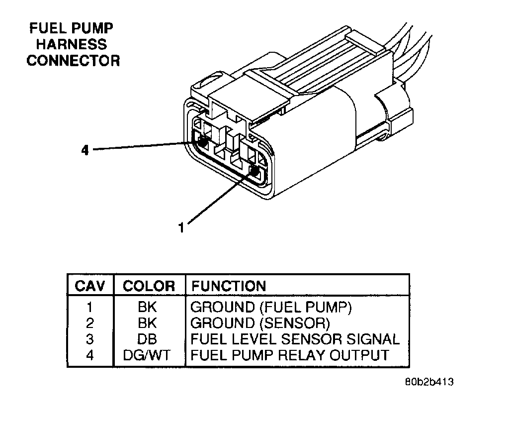

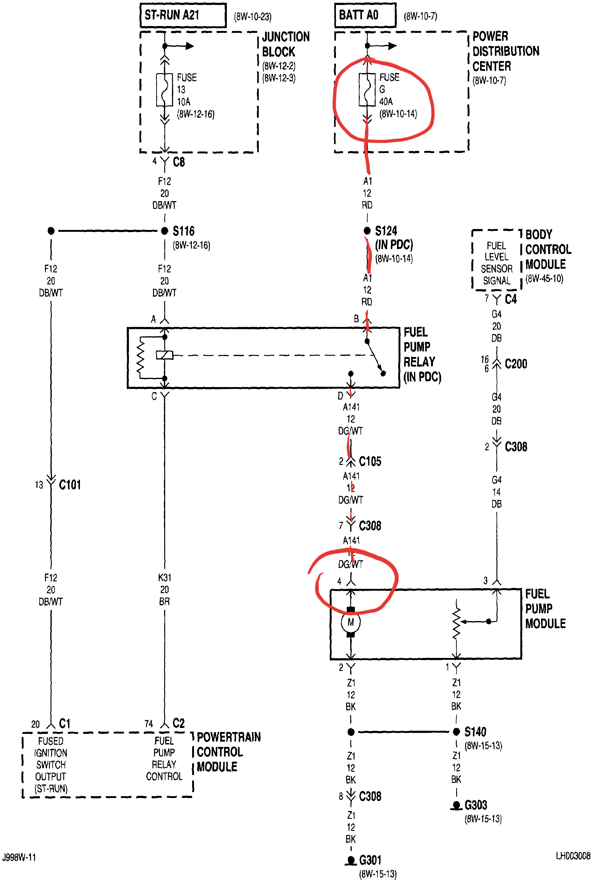

Car cranks but does not run. everything sounds like it's working; the alternator, starter and the fuel pump. I don't know why It does not start. Where is the fuel filter and will it cause a car not to run?

Fuel filter is integrated into the fuel pump. Your first step is to check for actual fuel pressure. Here is a link on checking fuel pressure. Attaching wiring diagram if you have no fuel pressure:
Check your fuse and check for power at the fuel pump connector pin #4 dark green wire with white stripe. Let us know what the pressure your reading and if there is battery voltage at the fuel pump connector.
