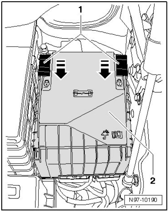

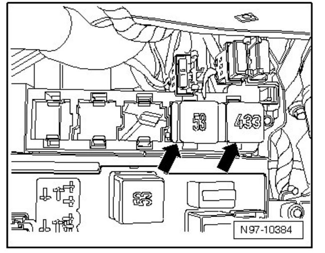

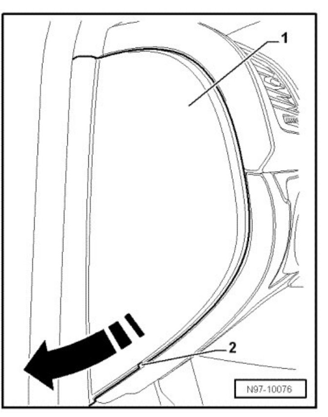

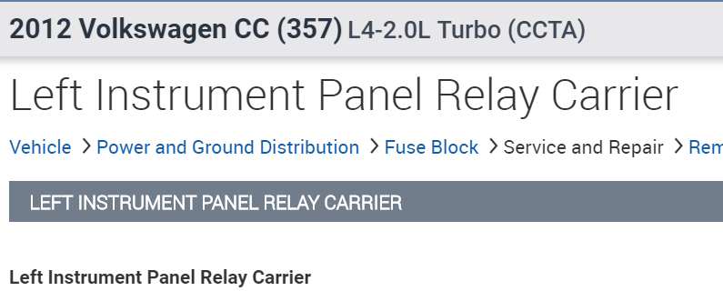

my driver side low beam will not come on even after I changed it.
Feb 14, 2019 at 7:30 AM
BRION
I checked all the wires and plugs and everything. I can’t figure out where the fuses are to even determine if that’s the reason why the lights don’t come on.
Feb 15, 2019 at 11:50 AM
SCGRANTURISMO
  • 4,897 POSTS
I have put the location and description of the three fuse panels/relay blocks in the diagrams below. I hope this helps.
Thanks,
Alex
