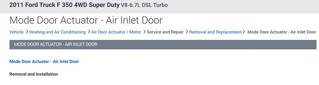

heater blows hot at standstill but gets colder the faster you drive. better temperature on recirculate but still gets cooler as you are driving.
Dec 16, 2019 at 8:15 AM
SCGRANTURISMO
  • 4,897 POSTS

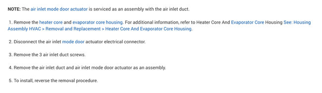

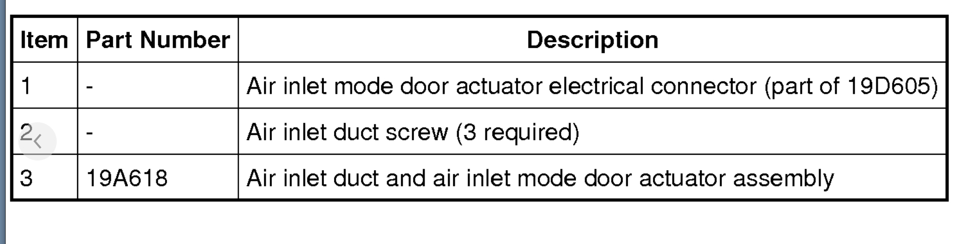

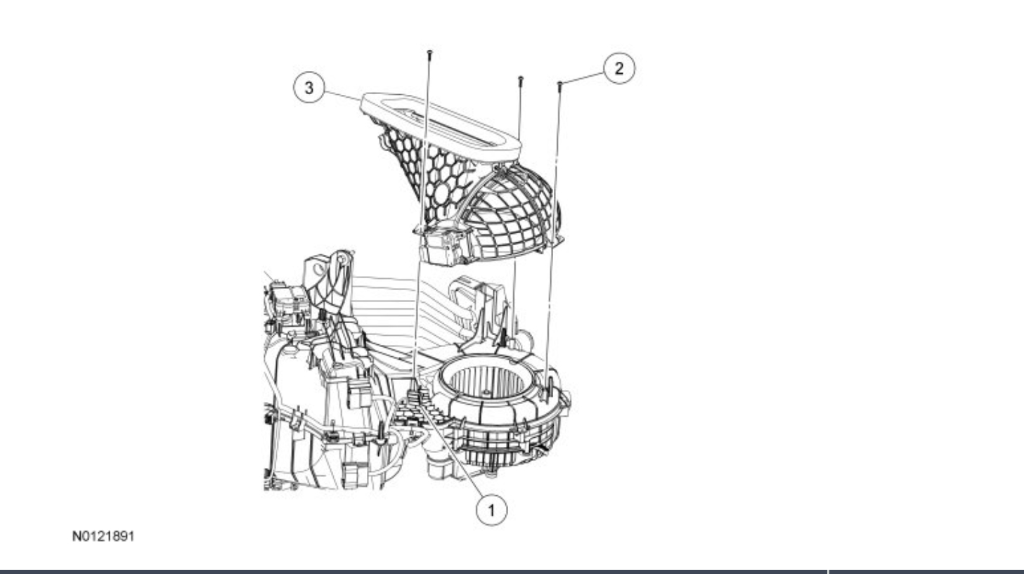

This does sound like a problem with your vehicle's air inlet door actuator. When the actuator, which is a little plastic servo or motor, fails, the air inlet door will be stuck in whatever position the door is when the actuator fails. In the diagrams down below I have included the instructions for the removal and installation of the air inlet door actuator. Please go through this guide and get back to us with how everything goes.
