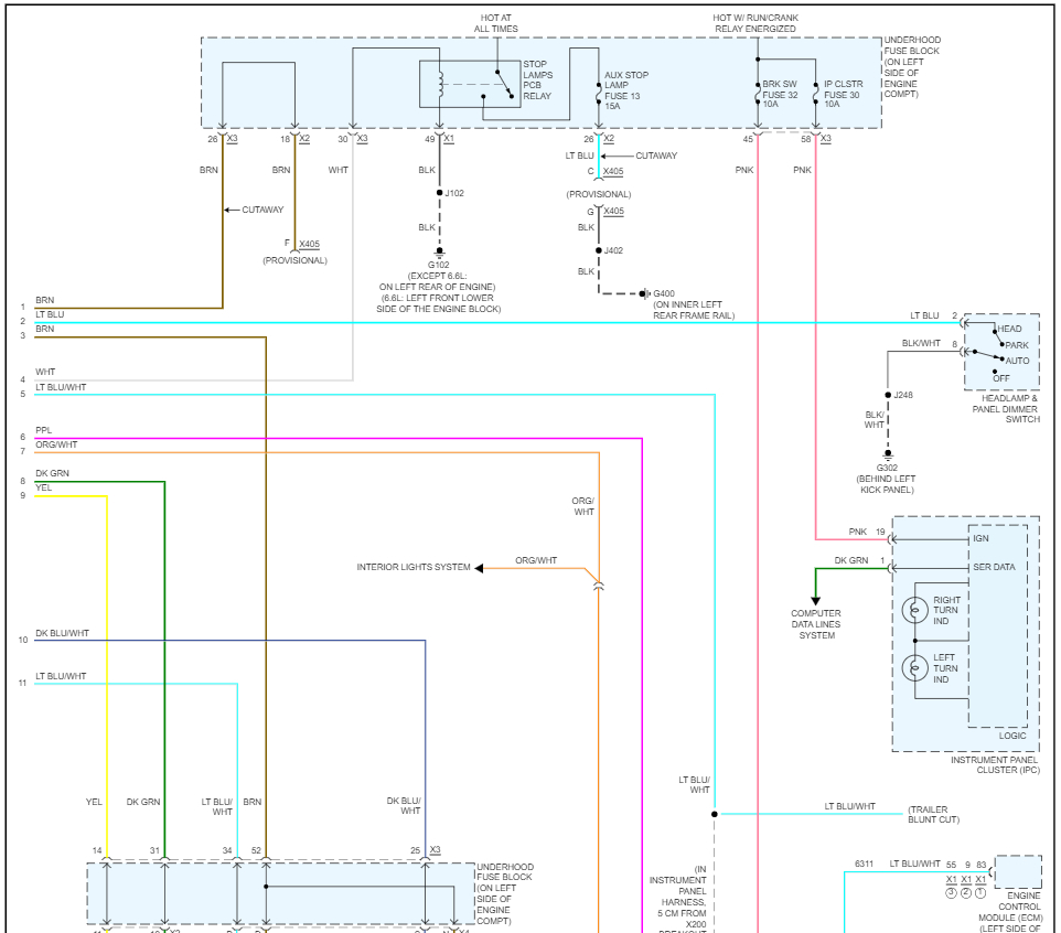

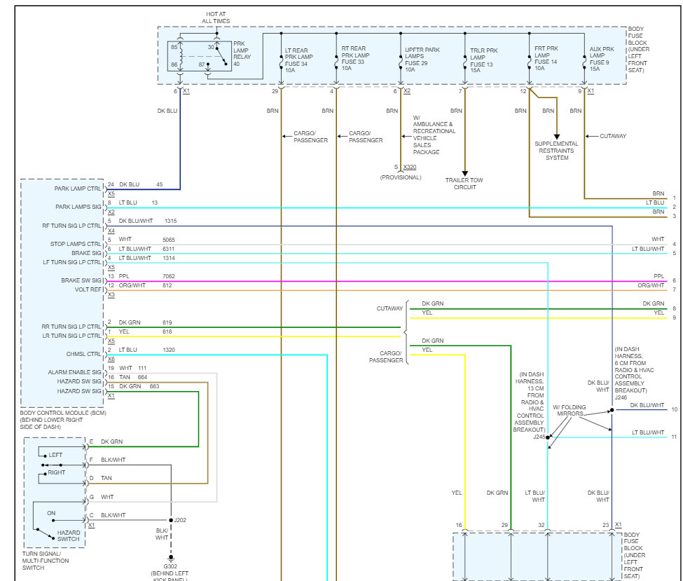

Where is the flasher module located?
30,000 MILES • 4.8L • V8 • 2WD
MARK GRAYSON SNYDER
I’m having trouble finding anything online for this makes year as to the location of the flasher module. Please help
May 11, 2023 at 1:02 AM
  • 55,766 POSTS

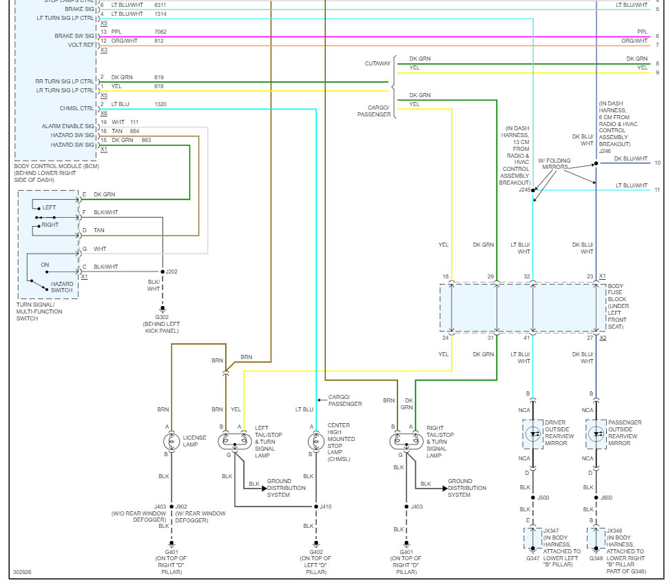

There is no flasher on this vehicle is the blinking operation is handled by the BCM. What kind of problem are you having? Here is a guide that can help, and I have included the blinker wiring diagrams so you can see how the system works. I would start by checking the blinker system fuses which you can see in the wiring diagrams.
https://www.2carpros.com/articles/turn-signals-not-working-blinker
and
May 11, 2023 at 4:47 AM
