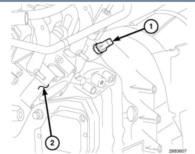

I’ve been trying to replace my coolant temperature sensor but I can’t not for the life of me find where it’s at. I could really use some help it would be greatly appreciated. thank you

Good afternoon,
I attached a picture and the procedure for you below.
https://www.2carpros.com/articles/coolant-temperature-sensor-cts-replacement
The Engine Coolant Temperature (ECT) sensor on the 3.6L engine is installed into a water jacket at rear of the cylinder head on the left side of the engine.
WARNING:
Hot, pressurized coolant can cause injury by scalding. Cooling system must be partially drained before removing the coolant temperature sensor.
NOTE:
Do not waste reusable coolant. If solution is clean, drain coolant into a clean container for reuse.
1. Partially drain the cooling system. See: Cooling System > Procedures
2. Disconnect the electrical connector from the sensor.
3. Remove the sensor from the cylinder head.
