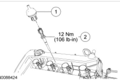

Where is the ect located not the cht the ect?
276,000 MILES • 2.4L • 4 CYL • 2WD • AUTOMATIC
SKYLINEDC3
Guage is not reading properly and neither is the ecm according to both the car is running at around 50-60 degrees Fahrenheit after 5 minutes of running

As far as I recall, the ect is located on the right-hand side of the engine above the bell housing. The CHT is on the top center of the cylinder head.
I tried finding pics of the sensor without any luck. However, if you check where I mentioned, you should find it.

So I went through every single thing I could find online and as it turns out for the 2010 ford transit connect xlt there is no ect only the cht so I was completely wrong on the premise of my question but I do thank you for responding

No problem whatsoever. The funny thing is even though there isn't one, if you look online, you can find the part that doesn't exist. LOL

Here is the location of the cylinder head temperature sensor which is between the spark plugs. Check out the images (below). JACOBANDNICKOLAS is one of our best!
