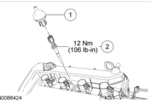

Where is the ect located not the cht the ect?
2010 FORD TRANSIT
276,000 MILES • 2.4L • 4 CYL • 2WD • AUTOMATIC
SKYLINEDC3
Guage is not reading properly and neither is the ecm according to both the car is running at around 50-60 degrees Fahrenheit after 5 minutes of running

So I went through every single thing I could find online and as it turns out for the 2010 ford transit connect xlt there is no ect only the cht so I was completely wrong on the premise of my question but I do thank you for responding

Here is the location of the cylinder head temperature sensor which is between the spark plugs. Check out the images (below). JACOBANDNICKOLAS is one of our best!
