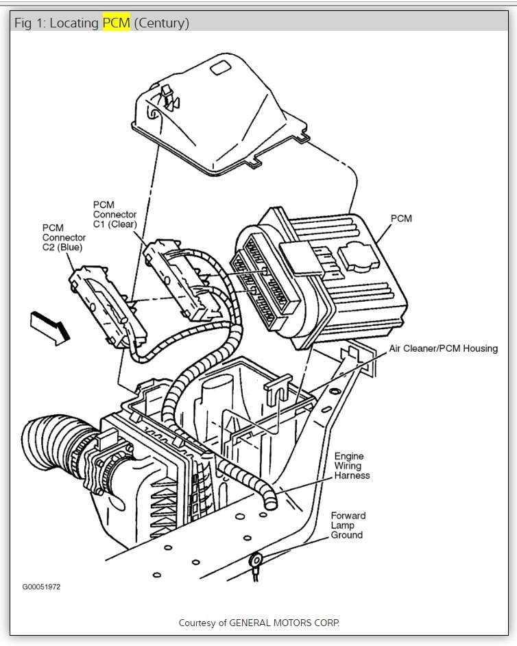

where is the ECM computer located?
2001 BUICK CENTURY
150,000 MILES • 3.1L • 6 CYL • FWD • AUTOMATIC
ARO
car will run for about 2 minutes stumbles and dies like its running out of fuel when I'm not getting correct data link between the computer and my analyzer are not working I think it needs an ecm where is it?
Nov 3, 2014 at 1:16 AM
  • 55,433 POSTS

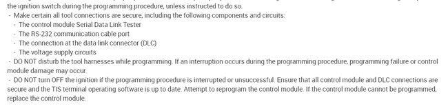

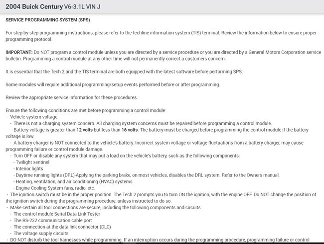

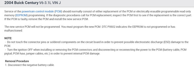

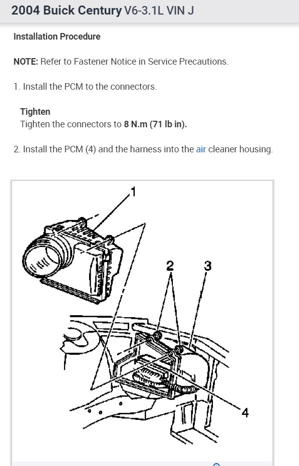

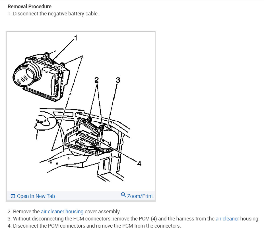

Hey ARO,
It looks like the PCM is located in the front part of the engine compartment on the drivers side. Check out the diagrams (Below). Please let us know what happens.
