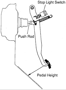

I have a '98 Avalon . The parking brake light which usually illuminates when the parking brake is applied, does not come on. I know that this light is a dual function light which also can indicate a brake issue. It operates fine and does come on when the key is turned to start, and then goes out.
It just doesn't come on when the parking brake is applied like it used to.
I looked under the dash around and near the pedal assembly , which is where I thought the switch should be, but I can't find it!!! Please help.
Dave
Nov 11, 2019 at 9:44 AM (Merged)
  • 75,992 POSTS
Parking Brake Switch Behind dash, on parking brake lever bracket. Check out the diagrams (Below). Please let us know if you need anything else to get the problem fixed.
  • 75,992 POSTS
Check at the parking brake lever
INSPECT PARKING BRAKE SWITCH OPERATION
Check that there is continuity between the terminal and switch body with the switch ON (switch pin released).
Check that there is no continuity between the terminal and switch body with the switch OFF (switch pin pushed in). If operation is not as specified, replace the switch or inspect ground point.
