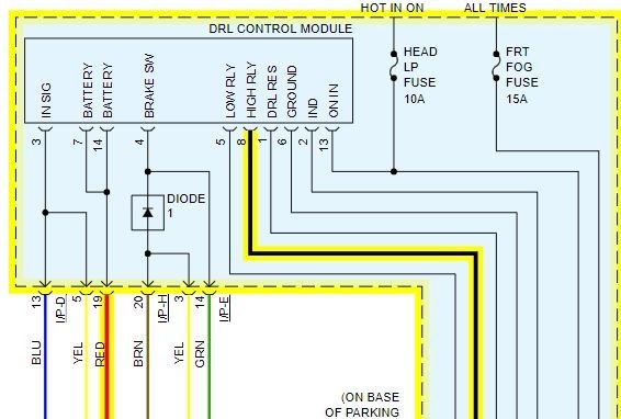

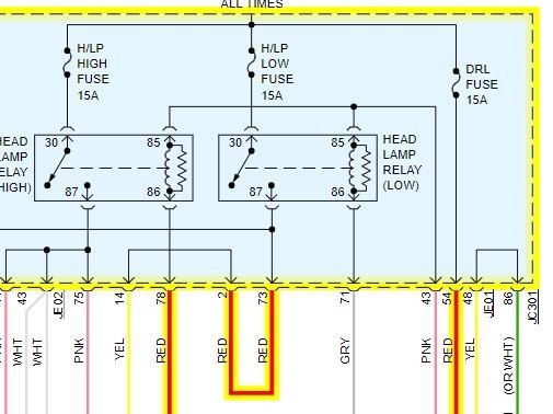

Where is the DRL module located?
Mar 2, 2019 at 12:49 AM
  • 110,194 POSTS
First, this specific vehicle isn't offered in the US, but the Kia Rondo should be the same vehicle with a different name plate.
With that in mind, the DRL module provides power through both the high and low beam relays. There isn't a relay specifically designated to the DRL. I have attached two pictures. The first shows the relays related to the high and low beam headlights. Note that power from them is supplied to the DRL module and then distributed from there.
