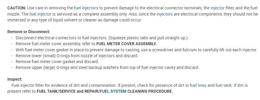

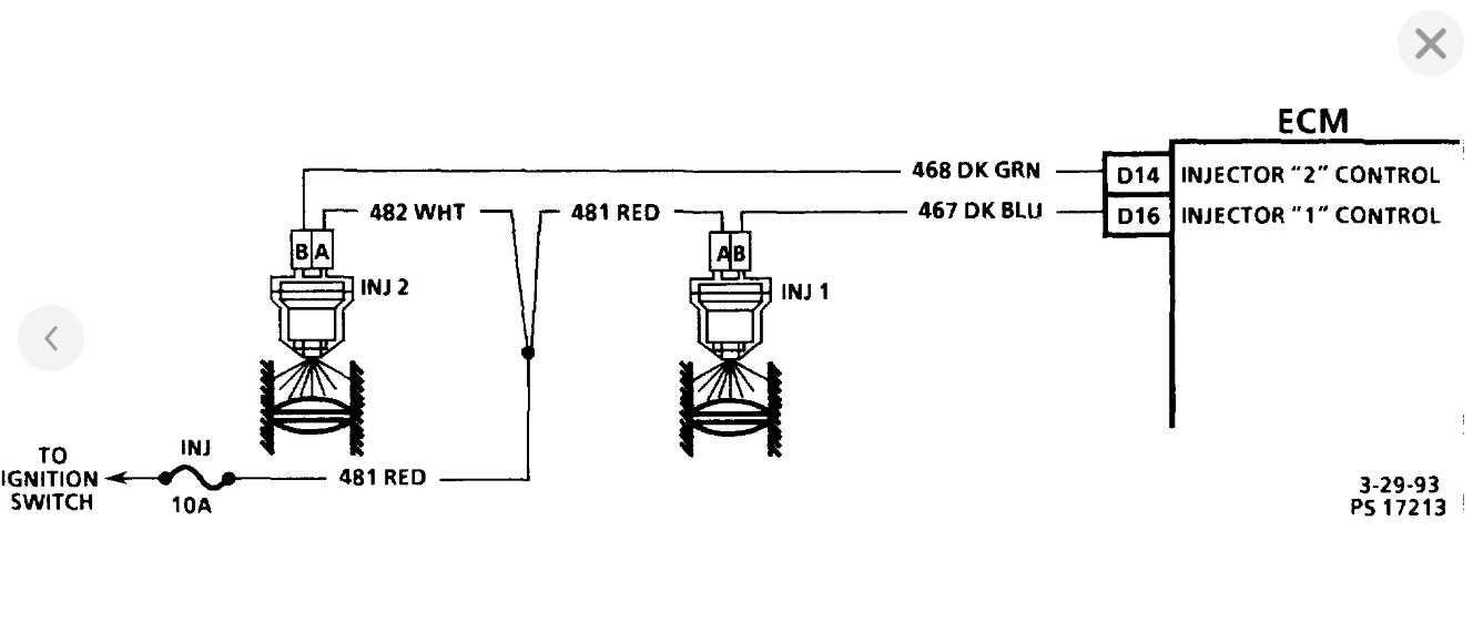

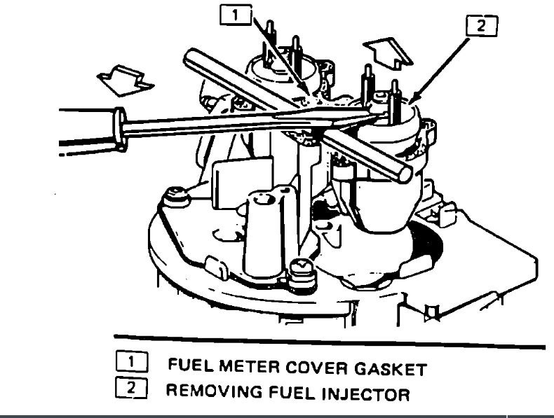

When it starts, do you see fuel dumping into the intake manifold?

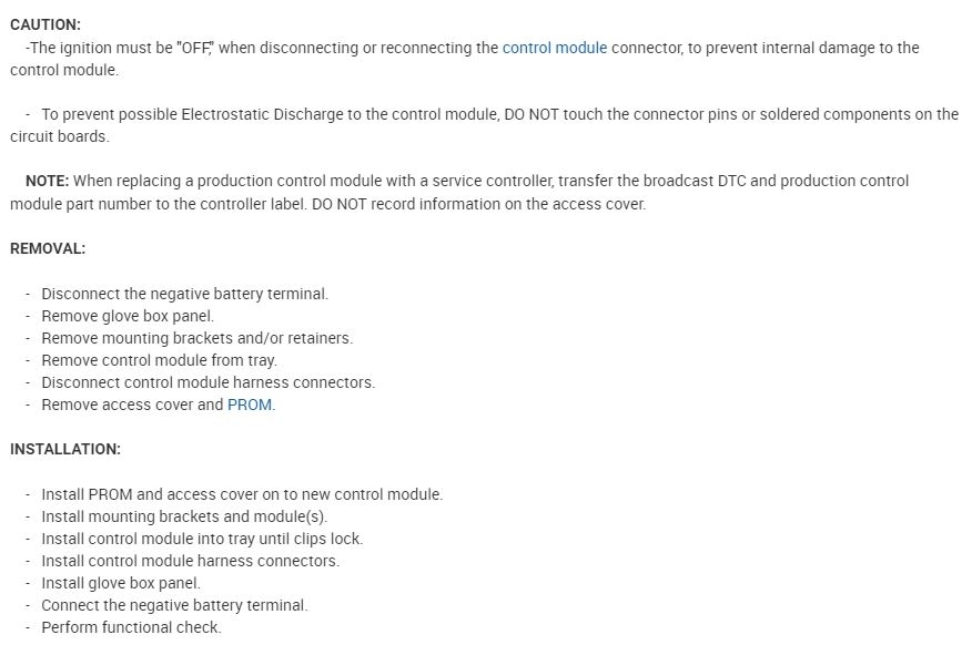

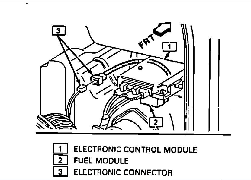

Chances are it either needs an ECM which controls the injectors, or the injectors themselves.
When you turn the key to the on position, do you see fuel coming out of the injectors?
Jan 21, 2020 at 2:50 AM
LEEWI88IS
No, no gas when you turn the key to the on position. But when you turn it over to start it you can see the fuel spraying out . is the a crank and cam shaft sensors?
Jan 21, 2020 at 6:00 AM
No, this is not a sensor.
Can you take a video of this while it happens?
I am wondering if it is the ECM or if you have a timing issue such as a bad timing chain.
