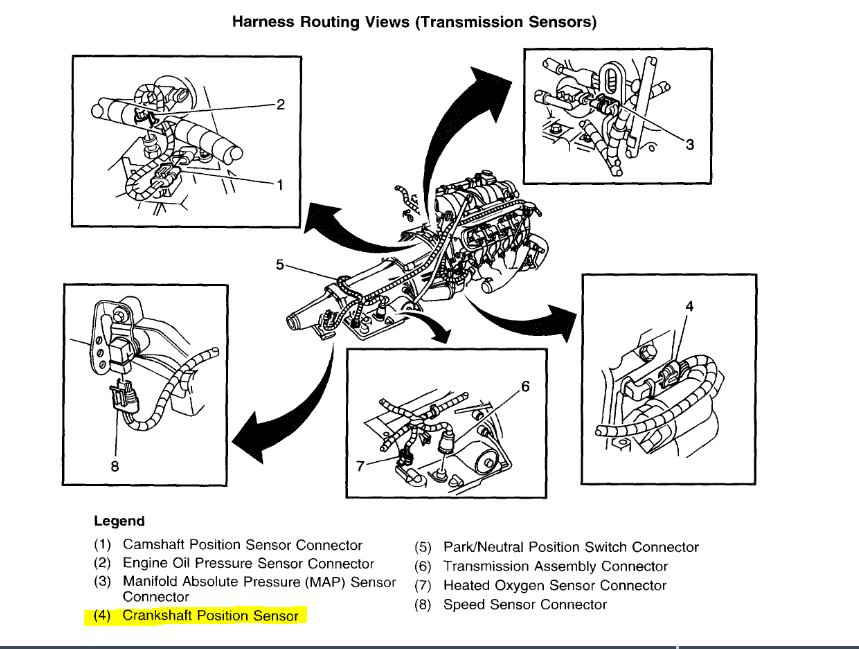

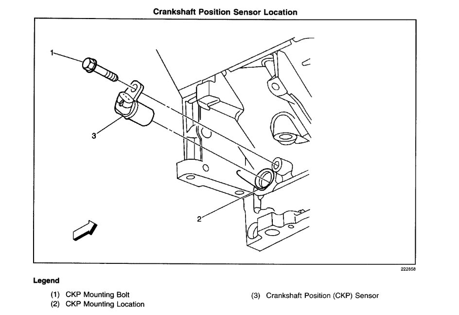

Where is the crankshaft position sensor? Car shut off while driving seen it could be the crankshaft position sensor or anything else it could be?
Oct 28, 2019 at 10:43 PM
SCGRANTURISMO
  • 4,897 POSTS

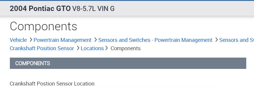

Yes, this does sound like it could be your vehicle's Crankshaft Position Sensor [CKP] or it's wiring. A broken timing belt would not be an issue here as your vehicle's engine is equipped with a timing chain. In the diagrams down below I have included diagrams of the location of the CKP and it's electrical connector for you. I hope this helps, and let us know if there anything else you need or how everything turns out, please.
