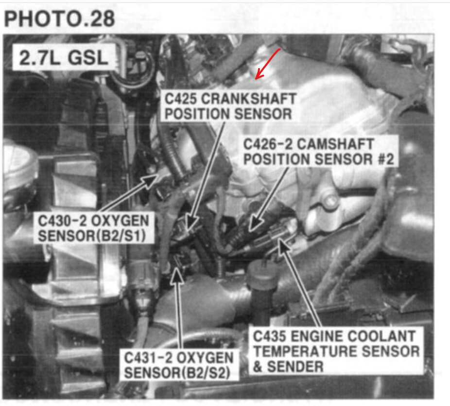

In addition to spending way too much time with the vehicle, I've been looking through a number of online forums, manuals, videos and I can't seem to locate the crankshaft position sensor.

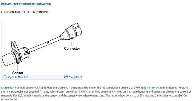

Sure, the crankshaft sensor is down low by the radiator. Check out the images (below). Let us know if you need anything else.
