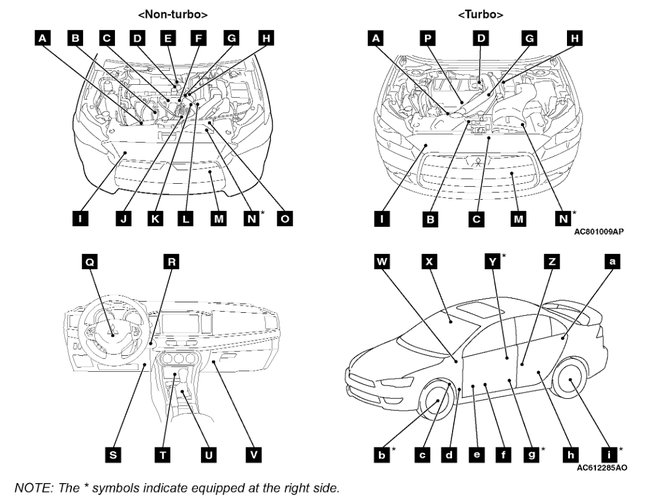

I cannot find coolant temperature sensor on my car, could someone help me locate it?
Jul 10, 2022 at 5:27 AM
  • 55,421 POSTS

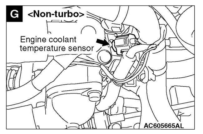

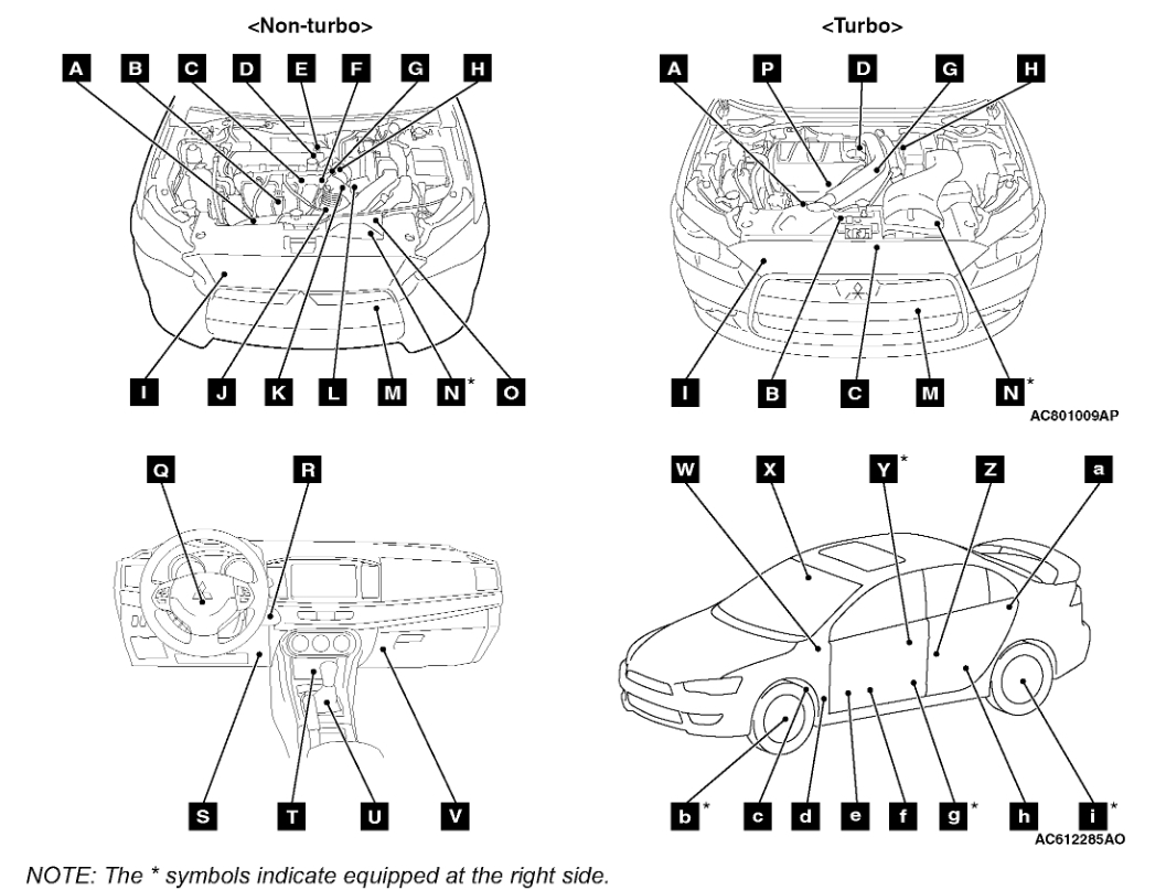

It looks like the coolant temperature sensor is near the rear of the engine (G), here is the location of the sensor in the diagrams below. Check out the diagrams (below). Please let us know if you need anything else to get the problem fixed.

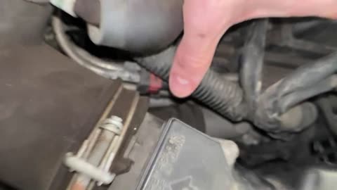

JAKE CURTI
  • 44 POSTS
Is it the red attachment? I’m having trouble.
Jul 11, 2022 at 3:02 AM
  • 55,421 POSTS
It is hard to tell from the video, but I think I saw it at the rear of the engine on the cylinder head. Let me know.

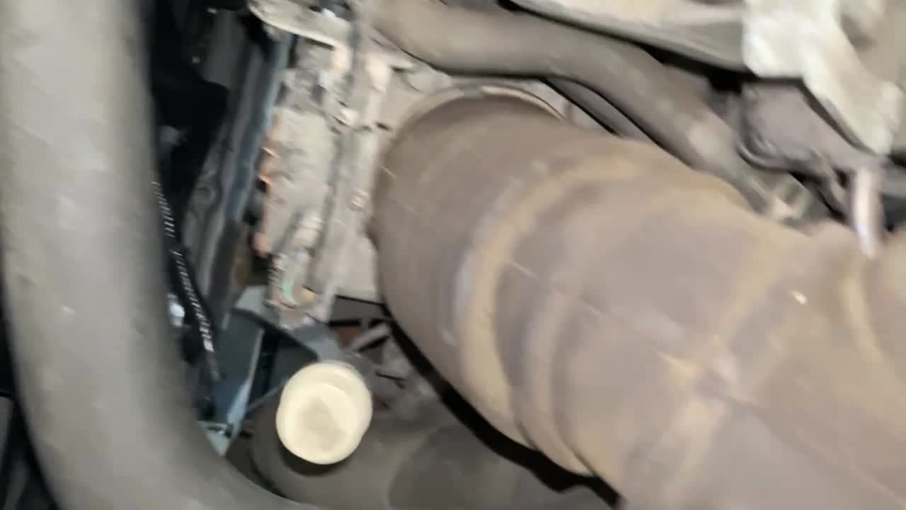

JAKE CURTI
  • 44 POSTS
Now our problem is that it's so far down and in such a tight space that we can’t even get it off.
Jul 11, 2022 at 11:45 AM
  • 55,421 POSTS
Sometimes you will need to remove other items to get to the sensor. If you upload another video of the area I can help.
