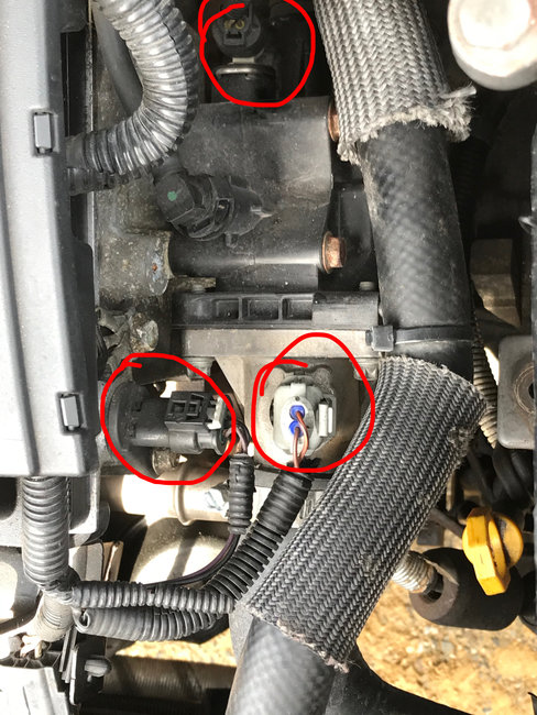

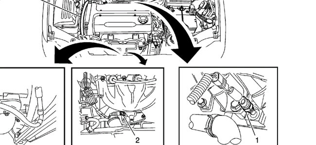

Is the sensor on the thermostat housing or would the other two I circle one of them? Please let me know. I would appreciate it.

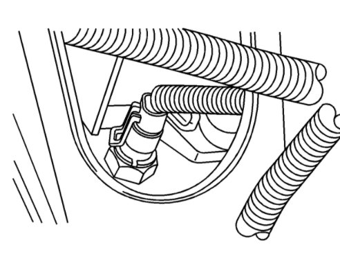

The coolant temperature sensor is mounted in the cylinder head. Here is a tutorial on how to replace a coolant temperature sensor:
https://www.2carpros.com/articles/coolant-temperature-sensor-cts-replacement
I've attached a picture below.Hope this helps and thanks for using 2CarPros.

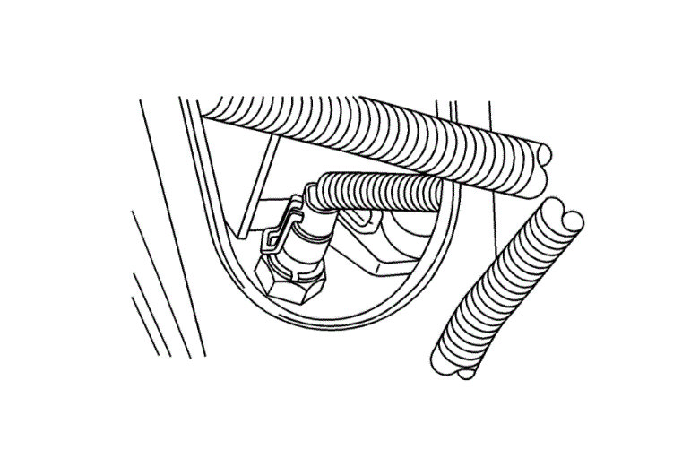

Good morning,
I attached the picture and location of the sensor for you.

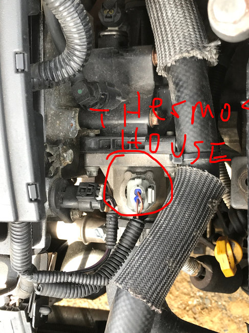

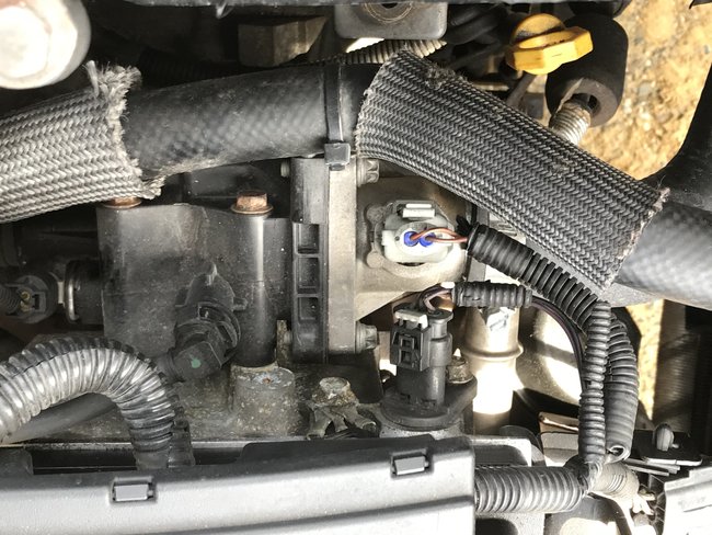

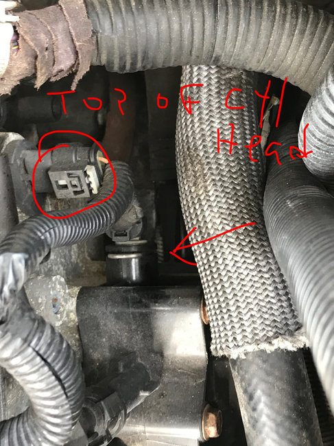

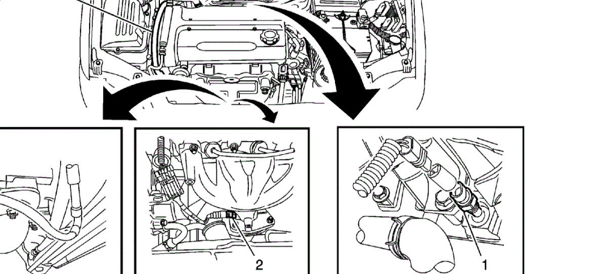

Thanks Roy and Danny for the reply’s. Question for Danny? When you say it’s in the cylinder head, is it in the front near the sensor that’s inside the thermostat housing? I ask because there is two sensors inside the cylinder head. One on top and one on the bottom. I thought that was the coolant temperature sensor in the thermostat housing. Let me know if it’s the sensor next to the one in the thermostat housing.
To show you exactly here is the pics.
Both in cylinder head and one in thermostat housing.

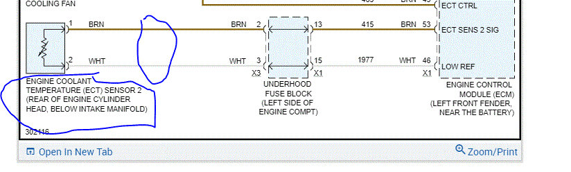

It is a 2 wire sensor. I attached another picture with the wire colors for you to match and the location description.

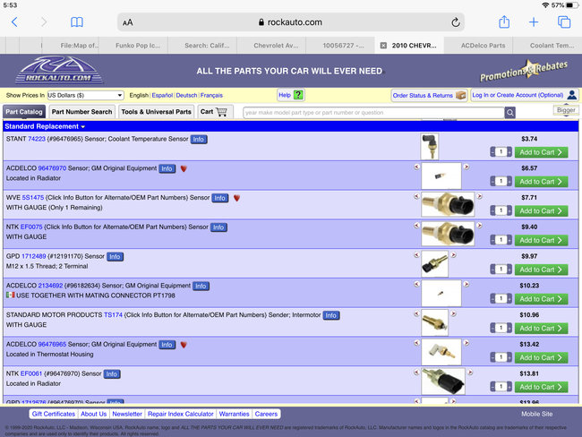

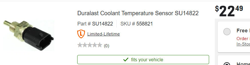

I was looking on Rockauto and see this. Do I have one in the radiator too? I don’t remember seeing one in the radiator? I just wanna make sure I get the right one. Never did one before in this type of car.

Okay, did you find the sensor with the color wires I listed in the diagram?

Here is a picture of a replacement coolant temperature sensor from AutoZone for your car. I've attached the picture below.In the notes from AutoZone it states the sensor is located in the radiator.You might want to check because sometimes our reference material contains mistakes. Hope this helps and thanks again for using 2CarPros.

Hi Danny, thanks for the knowledge. I did notice that on Rock Auto it seems like there are three sensors for this vehicle for the cooling system. One is located on the thermostat housing, other is on the radiator and in the rear of the head below the intake manifold. It’s confusing because Rock Auto says they are all coolant temperature sensors.
Aug 28, 2020 at 10:02 PM
I believe the one in the radiator is for the fan controls for the cooling fans.
There also may be a sensor for low coolant level in the radiator as well.
Aug 29, 2020 at 11:51 AM

But the coolant temperature sensor for the engine temperature is in the rear block?
Sep 2, 2020 at 9:40 AM
That is correct.
