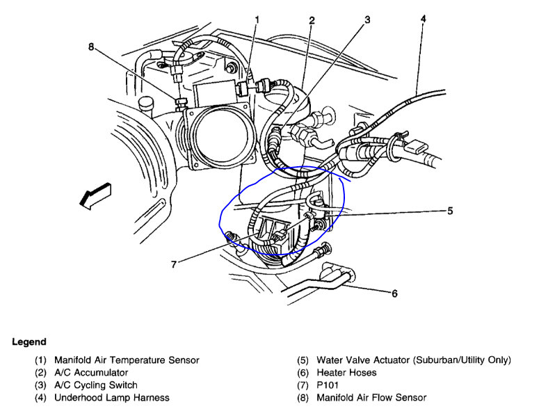

Condensation line must be clogged. Water is dripping on carpeting passenger side interior. I just need to know where line is to try to unclog it.

The drain tube is under the accumulator. There is no specific picture I can find, but I attached a picture for you to view. I circled the area the tube should be located.
It has a 90 degree elbow that gets clogged with debris. Remove the hose, it just pulls off, and clean it out of all debris.

Roy, would I get to it easier from above or below? Rick
Jul 6, 2019 at 3:02 AM
Usually from under the truck.
