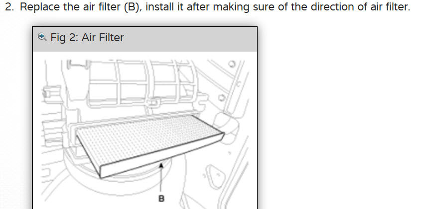

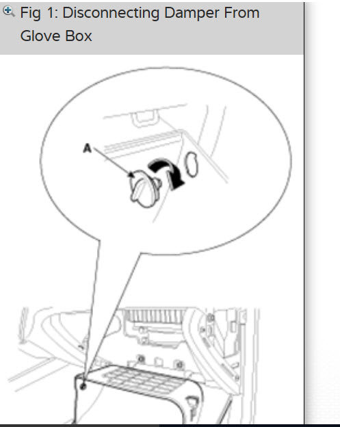

i do not know where the CCV filter is located.
Jul 2, 2017 at 1:20 AM
HMAC300
Experienced Mechanic
48,601 POSTS
not all cars have them unless they were dealer installed. See pictures for install/removal.
