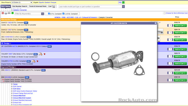

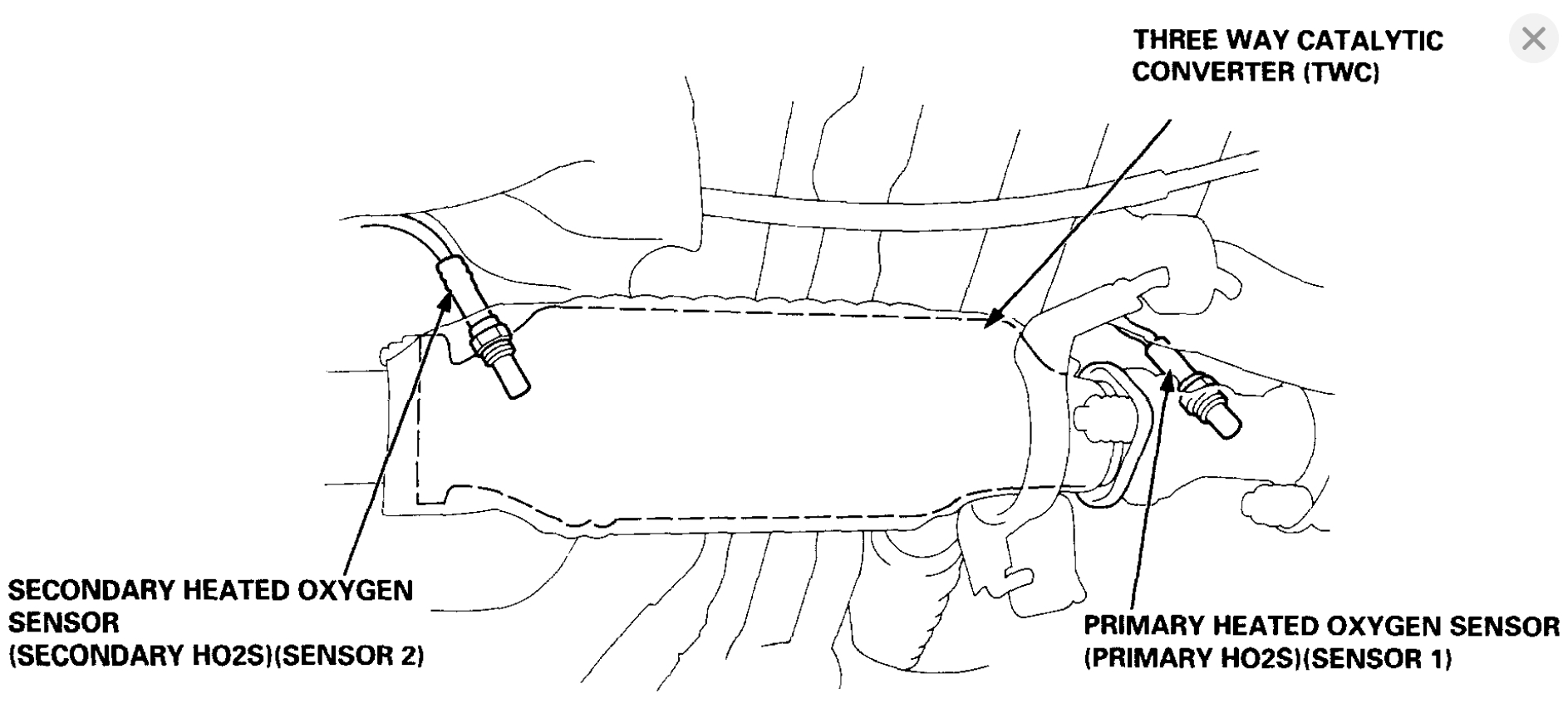

I need to find out where the catalytic converter is located on my car.
Jul 15, 2021 at 6:42 PM
Good morning,

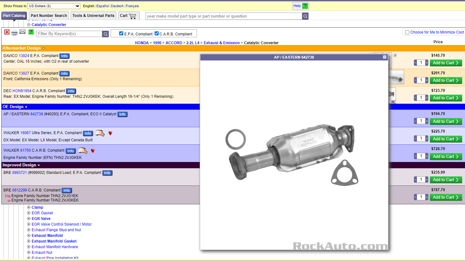

I attached the location of the catalytic converter for you to view. I also attached the part for you so you can match them up.
https://www.2carpros.com/articles/catalytic-converter-replacement
You need to release the bolts on the front and rear of the converter. You need to release the O2 sensors as well. You will need a special socket for that. You can get that at a parts store.
