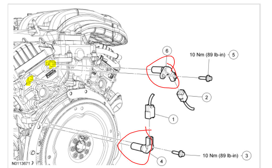

Where is the camshaft position sensor located?
2014 FORD MUSTANG
140,000 MILES • 3.7L • V6 • 2WD • AUTOMATIC
RAYRAY1578
Scanner says there is a fault on camshaft position Bank 1 Sensor A.
Mar 15, 2024 at 3:47 PM
  • 110,194 POSTS

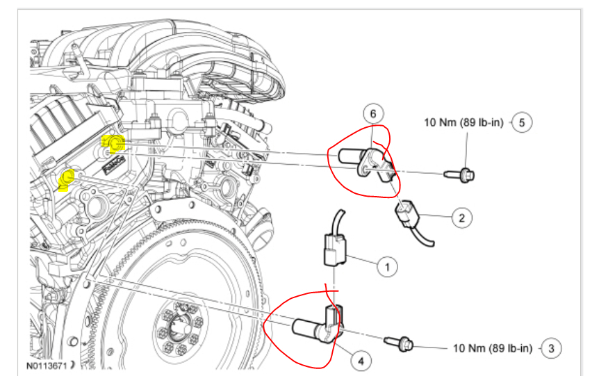

There are actually four camshaft position sensors. They are all located at the rear of the engine.

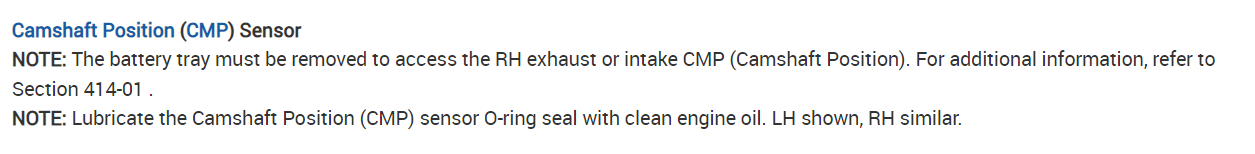

I attached two pics below. Pic 1 indicates the battery box needs to be replaced for one side of the engine.
Pic 2 shows the locations of the sensors on the left side of the engine. There are two more on the right side in basically the same positioning.
Note: Each side has an exhaust and an intake camshaft sensor. If you are not sure which you should replace, let me know what code or codes you have, and I should be able to determine which one is the issue or if you should be looking at something different.
