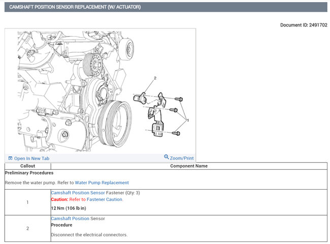

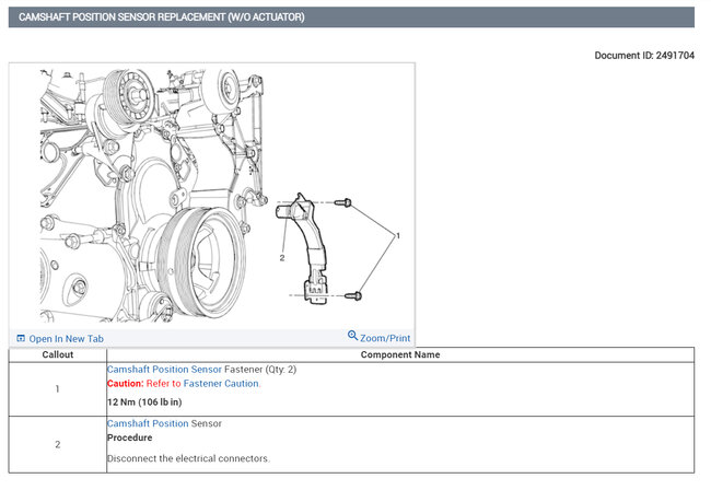

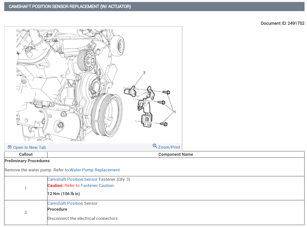

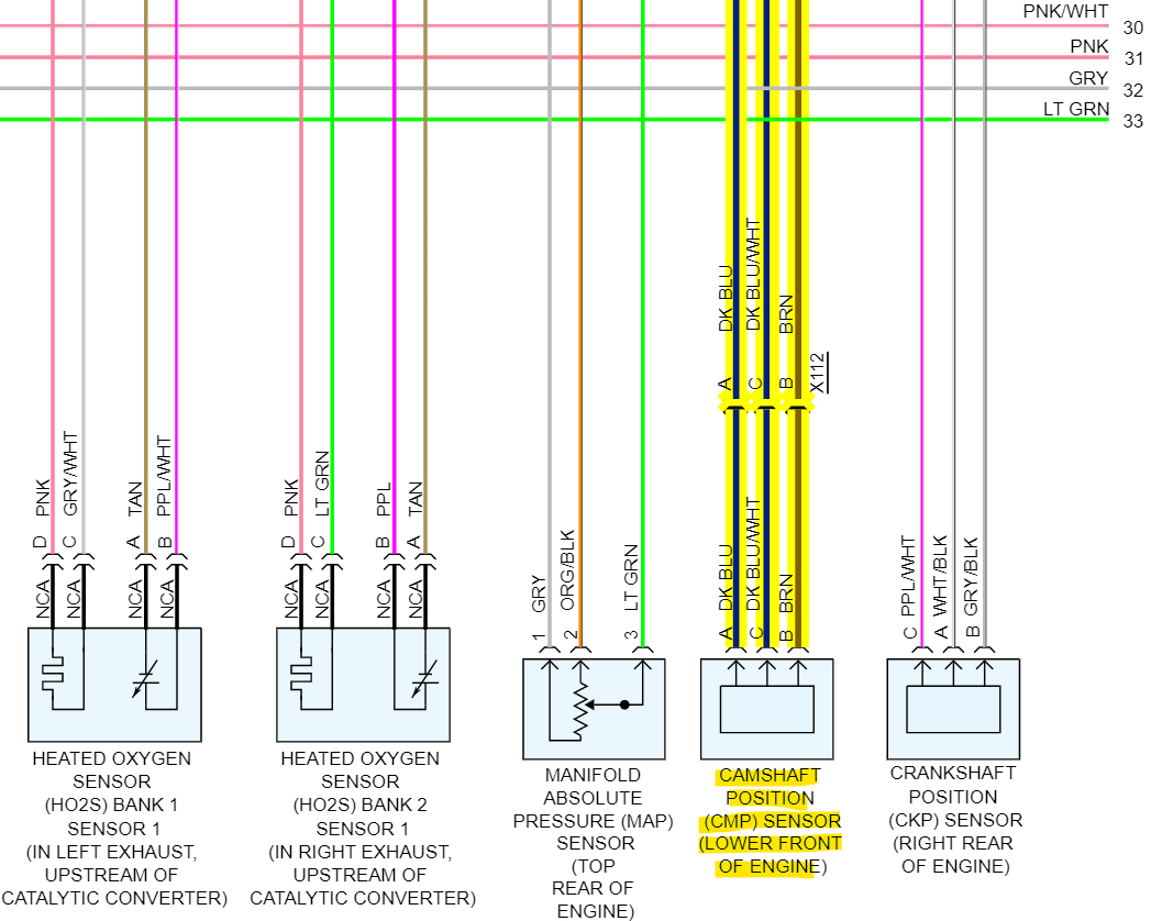

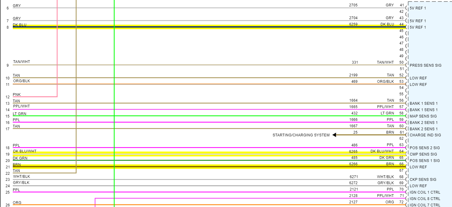

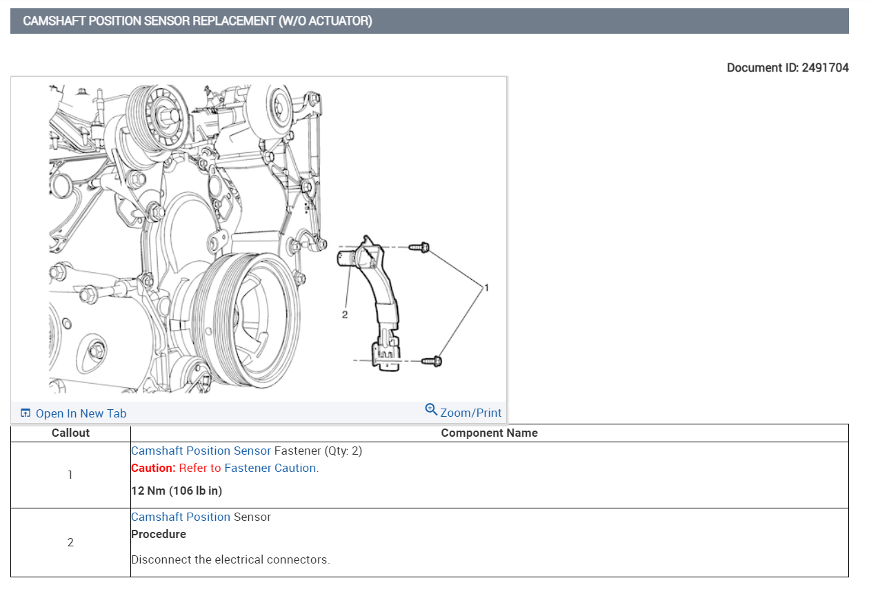

Problem locating the camshaft position sensor.
Feb 13, 2023 at 10:18 PM
AL514
Experienced Mechanic
5,700 POSTS
Hello, the camshaft position sensor is in an odd place on this one, it's right above the harmonic balancer (Crankshaft pulley). I'll post diagrams of its location and wiring colors. But it's on the front of the engine.
https://www.2carpros.com/articles/camshaft-angle-sensor-replacement
