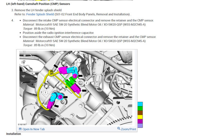

Code P0012, I'll start with the sensor as my first step but I can't find where this is located?
Apr 21, 2021 at 11:21 AM
Experienced Mechanic
52,796 POSTS
Good morning,

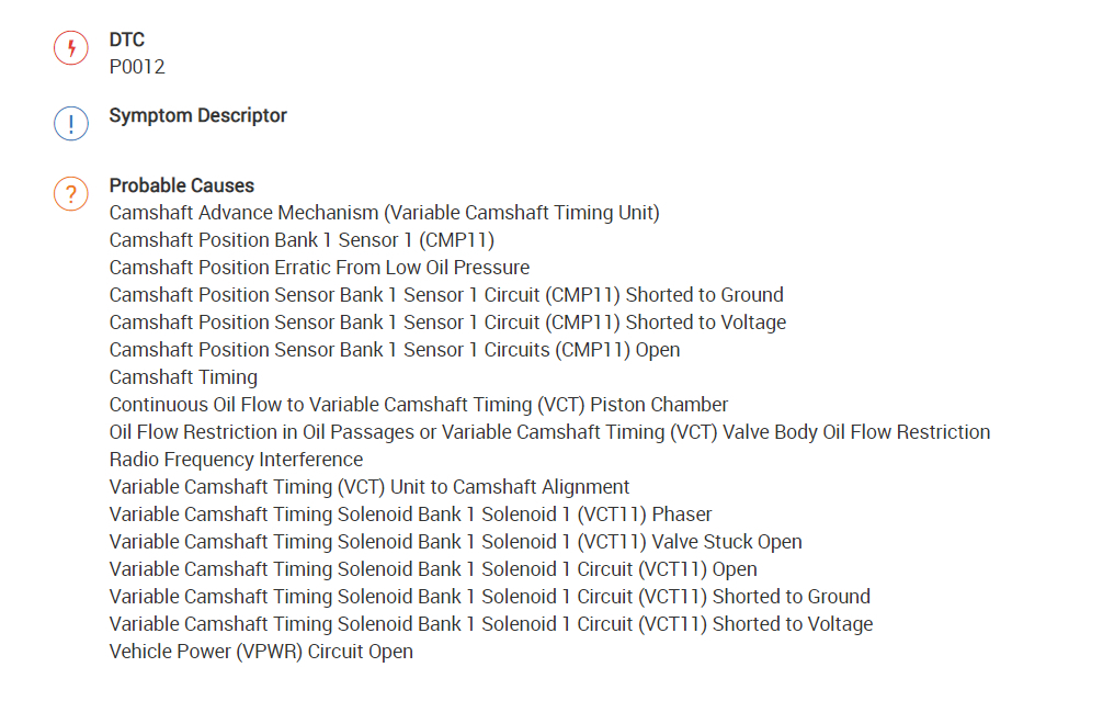

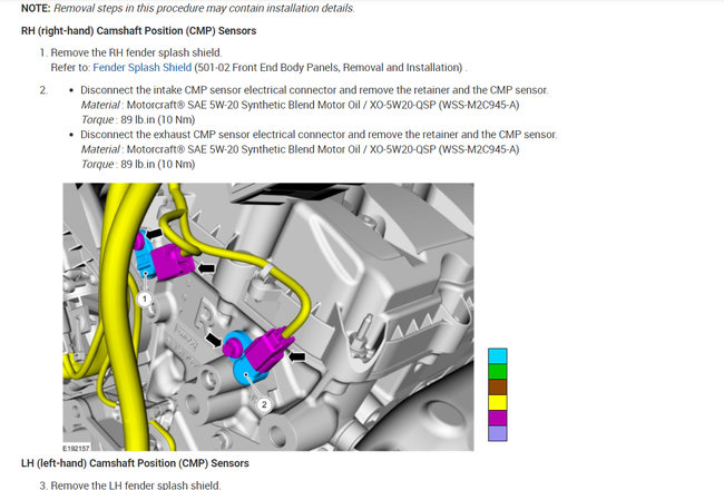

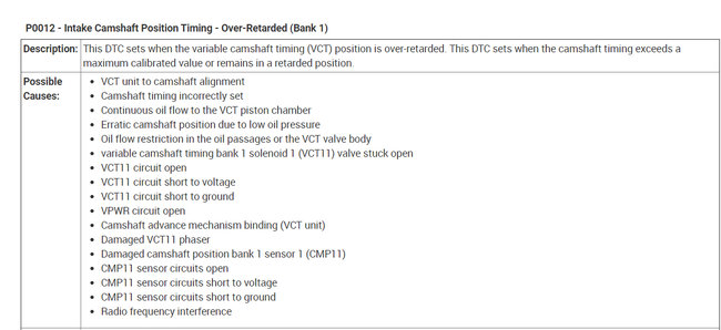

The code is for cam sensor 1 bank 1. That is on the back of the passenger side of the motor, the outer sensor.
https://www.2carpros.com/articles/camshaft-angle-sensor-replacement
I attached the possibilities and the procedure for you below.

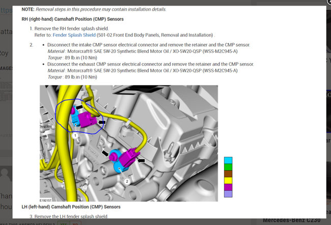

Thank you for your reply! Excuse my ignorance but can you circle the one I should be removing? thanks in advanced.
Apr 22, 2021 at 6:49 AM
52,796 POSTS
You are welcome.
I attached the picture and circled the sensor. Click to enlarged the image.
Image (Click to enlarge)

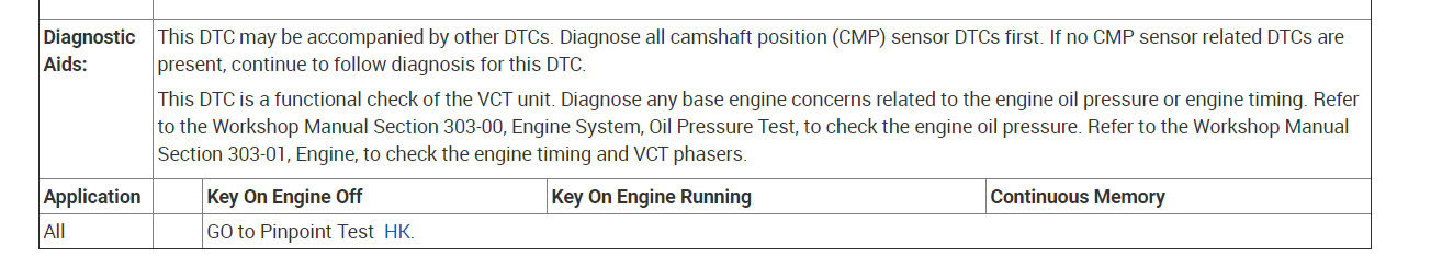

Usually when we get that code, it's not the sensor as it's the camshaft phaser not staying in place commanded.
