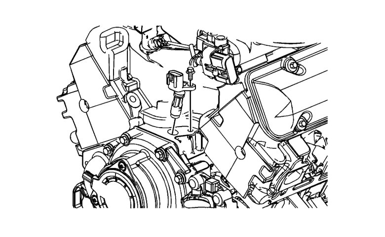

camshaft position sensor.
Oct 12, 2019 at 8:11 PM
Good morning,
It is behind and below the power steering pump.
1. Remove the power steering pump. Refer to Power Steering Pump Replacement See: Power Steering Pump > Removal and Replacement > Power Steering Pump Replacement.
2. Disconnect the camshaft position (CMP) sensor electrical connector.
3. Remove the CMP sensor bolt.
4. Remove the CMP sensor.
5. Inspect the sensor O-ring for wear, cracks, or leakage if the sensor is not being replaced.
