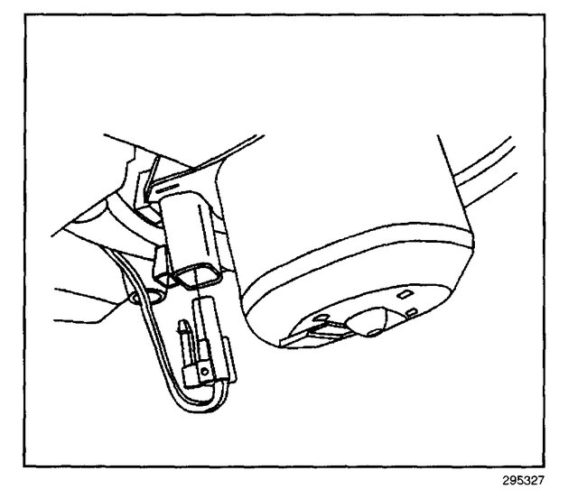

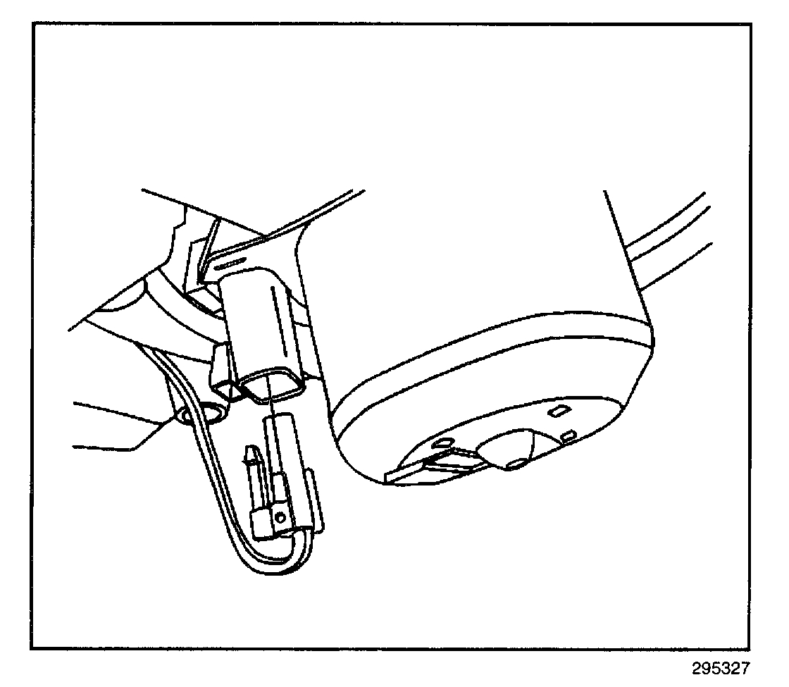

Where is the blower motor located
209,000 MILES
BUTNING.BUSH
I think I know where it is, but I want to be confident when the time comes.
Jan 8, 2020 at 12:47 PM
  • 110,251 POSTS
The blower motor is under the dash toward the passenger side. Here is a link that shows in general how one is replaced:
https://www.2carpros.com/articles/blower-fan-motor-works-on-high-speed-only
Here are the directions specific to your vehicle for replacement. The attached pics correlate with the directions. In pic 1, I highlighted the blower motor.
_________________________________________________
2001 Buick Regal V6-3.8L VIN K
Blower Motor and Fan Replacement
REMOVAL PROCEDURE

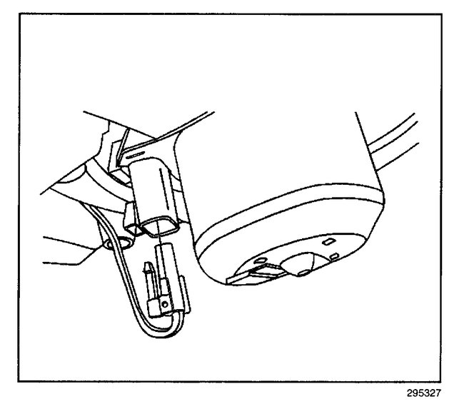

pic 2
1. Remove the right side instrument panel insulator.
2. Release the instrument panel harness retainer and position the harness aside.
3. Disconnect the blower motor electrical connector.

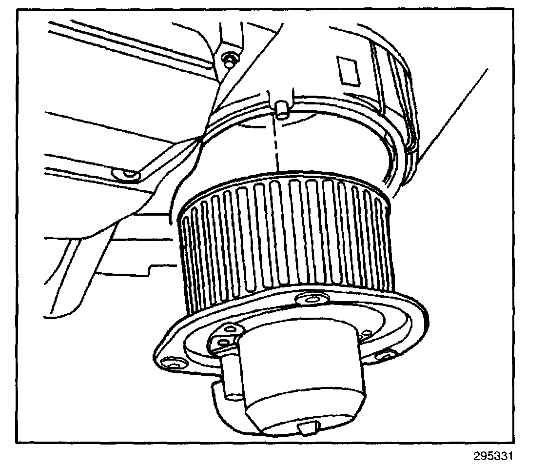

pic 3
4. Disconnect the blower motor cooling hose.
5. Remove the blower motor mounting screws.
6. Remove the blower motor.
INSTALLATION PROCEDURE

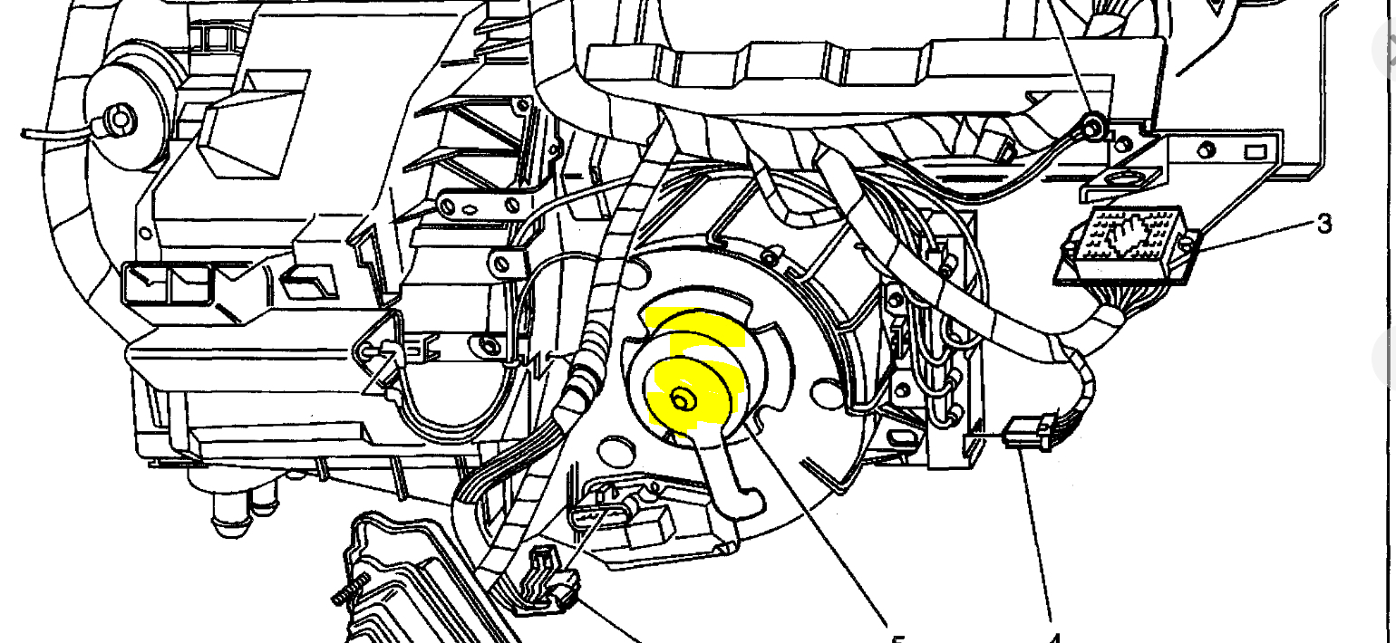

pic 4
1. Install the blower motor.
NOTE: Refer to Fastener Notice in Service Precautions.
2. Install the blower motor screws.
Tighten
Tighten the blower motor screws to 1.3 N.m (12 lb in).
3. Connect the blower motor cooling hose.

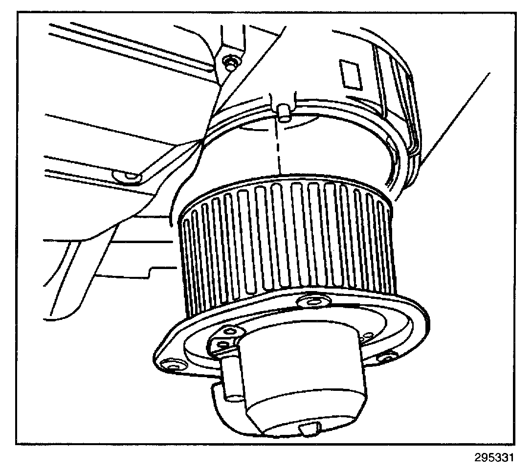

pic 5
4. Connect the blower motor electrical connector.
5. Install the instrument panel harness into the harness retainer.
6. Install the right side instrument panel insulator.

Let me know if this is what you needed or if you have other questions.
