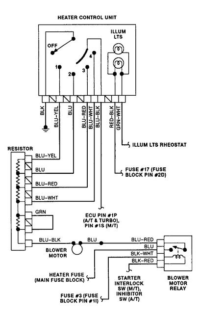

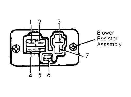

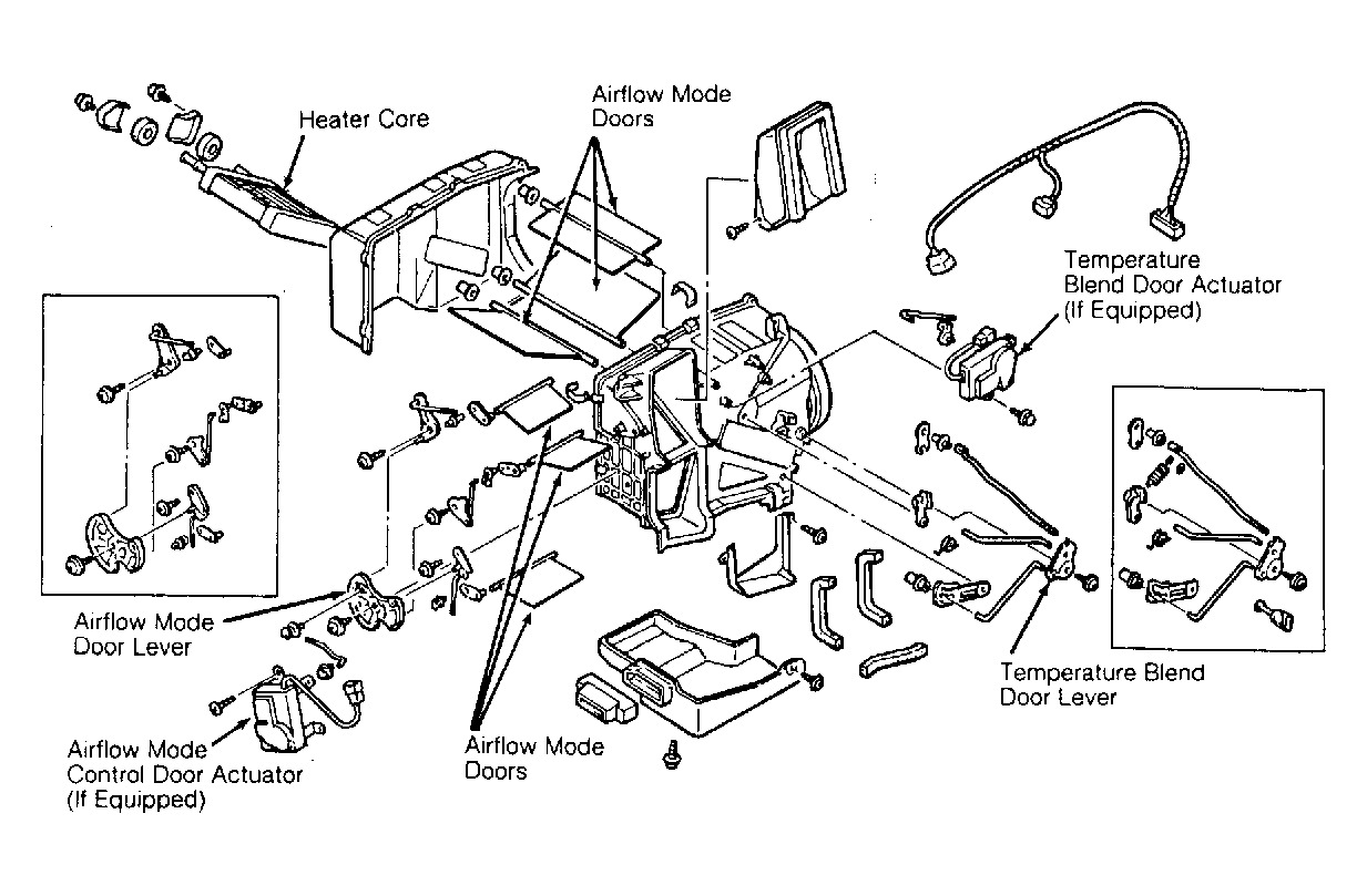

Blower only works on 3. I think I need to change the resistor but I don't know where it is.

LOOKS LIKE IN THE EXPLODED VIEW, IT'S IN THE DUCT, IN THE MIDDLE BOTTOM
I GRABBED EXTRA STUFF FOR YOU IN "MITCHELL I"...FOR INSTANCE THE WIRE COLORS MAY HELP VERIFY IT TOO

Remove undercover and glove box. Disconnect electrical connectors from blower resistor. Remove blower resistor. To install, reverse removal procedure
