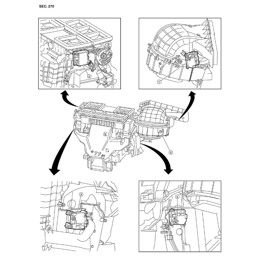

Where is the blend door actuator located?
2016 NISSAN MURANO
93,452 MILES
STEPHANIE ALICIA
My heat will blow but then it will just blow like fan like temperature. I also hear a clicking noise.
Jan 30, 2023 at 2:30 AM
  • 55,433 POSTS

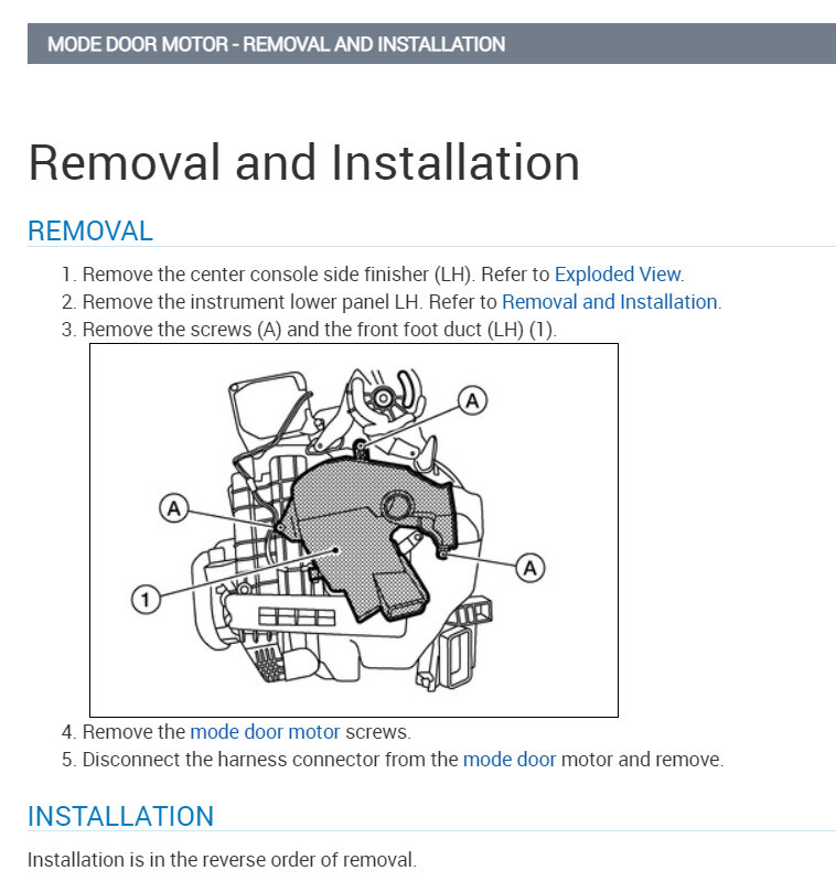

Yep, that ticking noise is telling you the actuator is bad here is the location so you can change it out to fix the problem. There are more than one so to confirm the problem you should be able to feel the actuator clicking. From what you have described I would say the Mode door actuator is bad. Check out the images (below). Please let us know what happens.
Jan 30, 2023 at 3:35 AM
STEPHANIE ALICIA
It sounds like it's under the steering wheel. Is this the correct diagram for it?
Jan 30, 2023 at 5:38 AM
  • 55,433 POSTS
Sure is, please let us know.
