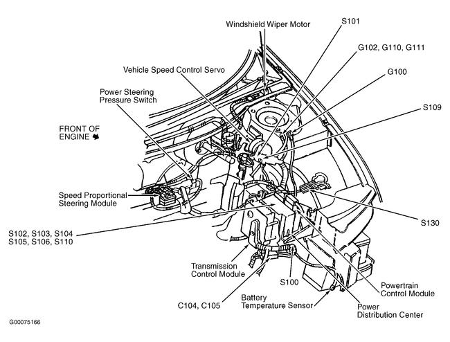

where is the battery temp sensor on the dodge stratus
180,000 MILES • 2.0L • 4 CYL • 2WD • AUTOMATIC
LACHYTOON
  • 21 POSTS
I went to autozone to scan my car and it shows code p01492 battery temp sensor to high I want to know where is that sensor.

It's on the rear side of the front bumper beam (in front of the battery). See attached pic. Also, note that there are other reasons for this code to be set. The sensor could be fine.

thank you very much problem solved
