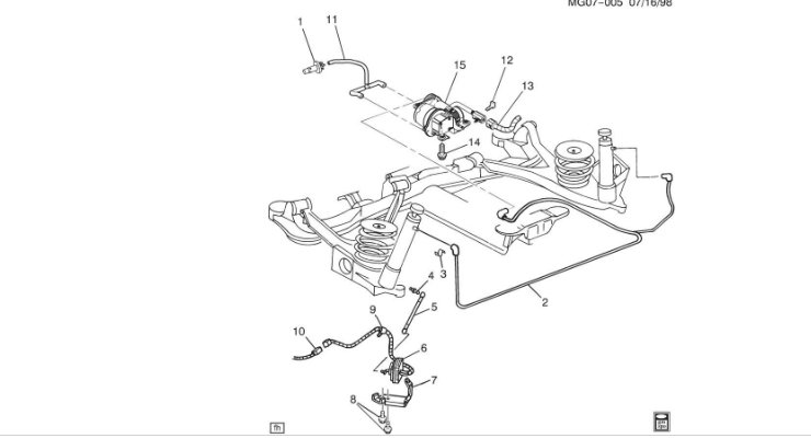

where is the air pump/compressor located?
1999 OLDSMOBILE AURORA
175,100 MILES • 4.0L • V8 • FWD • AUTOMATIC
DEDHED70
I recently purchased a used Aurora & want to change the rear shocks because it does not rise when I have passengers in the rear. I just wanted to know where is the air pump/compressor is located and what would be the best replacement for the shocks?

you can replace the air ones with ones that are not air and have but I forget the name of the company that makes them. the compressor is below right rear of vehicle.

Here is a diagram on where to find it! It is label number 15.
