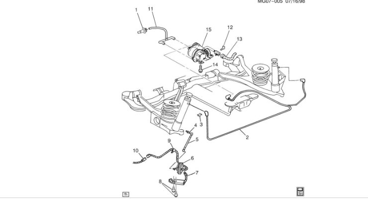

Where is the air pump/compressor located?
DEDHED70
  • 1999 OLDSMOBILE AURORA
  • 4.0L
  • V8
  • FWD
  • 175,100 MILES
I recently purchased a used Aurora & want to change the rear shocks because it does not rise when I have passengers in the rear. I just wanted to know where is the air pump/compressor is located and what would be the best replacement for the shocks?

You can replace the air ones with ones that are not air and have but I forget the name of the company that makes them. The compressor is below right rear of vehicle.

Here is a diagram on where to find it! It is label number 15.
