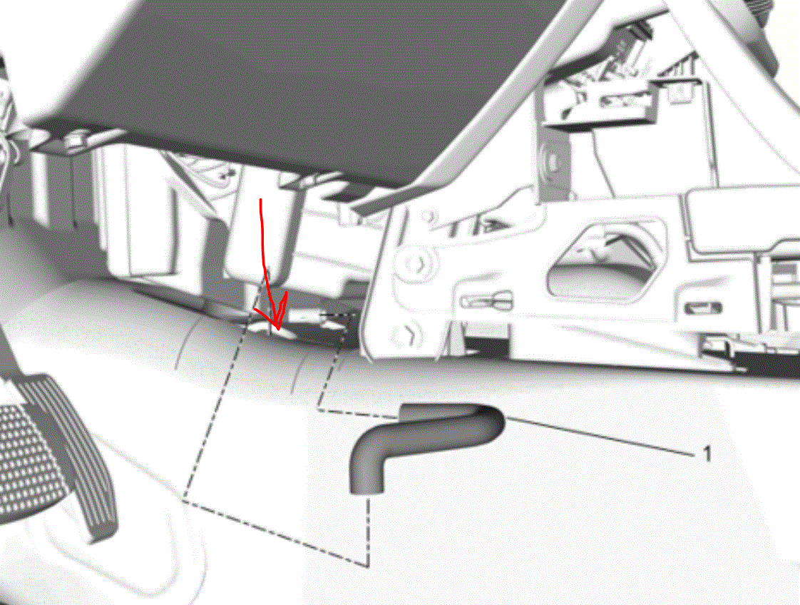

Truck listed above is a diesel. Noticed water comes from driver side the opposite of the exhaust side, drips from bottom of firewall insulation don't see a hose.
May 30, 2020 at 8:23 AM
  • 110,194 POSTS
I attached a pic to help you get an idea where it is. You would have to pull back the carpet to see it but it is on the passenger side bottom. If I recall, the 2017 has a grommet that is about an inch long that sticks through the bottom of the firewall. There isn't a long hose or anything like that..
Let me know if this helps.
May 30, 2020 at 7:02 PM
CANYONDEZEL
Thank you for the prompt reply. I'm looking at the picture posted and it looks like the driver side in this picture due to the pedals on the left and it drips on the driver side, but you are saying it's on the passenger side? Just want to double check before I start pulling up carpet, lol. Every other truck I've had drips by the exhaust but not this one.
May 30, 2020 at 9:13 PM
  • 110,194 POSTS
Honestly, it is on the passenger side. What I have seen is because of the length of the drain, the water seems to drip where it wants. They had issues a few years before your vehicle where the grommet would leak and the water would soak the carpet. Ugh!!

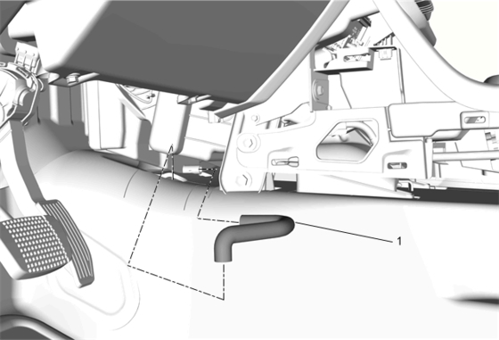

Here are the directions for replacement of the hose. Very vague.
2017 GMC Truck Canyon 4WD L4-2.8L DSL Turbo
Air Conditioning Evaporator Module Drain Hose Replacement
Vehicle Heating and Air Conditioning Evaporator Drain Tube Service and Repair Removal and Replacement Air Conditioning Evaporator Module Drain Hose Replacement
AIR CONDITIONING EVAPORATOR MODULE DRAIN HOSE REPLACEMENT
Document ID: 3767678
See pic 1
Call out Component Name
Caution: Refer to HVAC Module Drain Tube Caution.
Preliminary Procedure
Front Floor Console Extension Panel Replacement
1 Air Conditioning Evaporator and Blower Module Case Drain Hose
