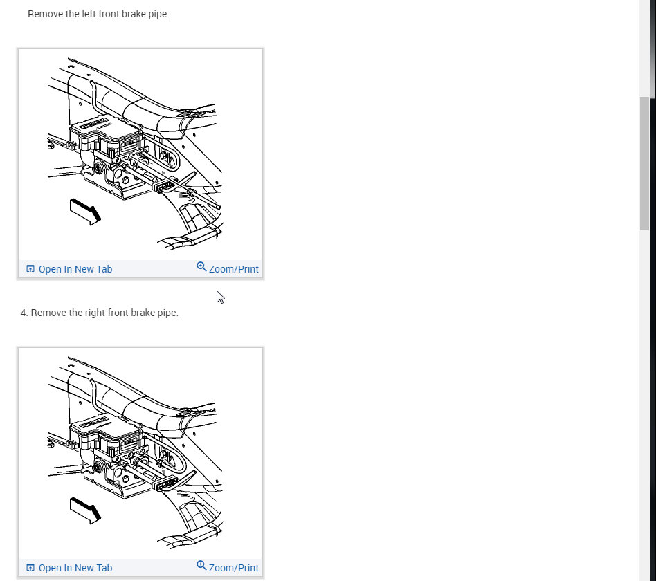

I've scoured YouTube, diagrams, and read the information on this site, but I cannot locate the ABS Control Module. The images on here make it look like it maybe underneath? Please help me find this.
GLORIANNA
Nov 16, 2019 at 3:25 AM

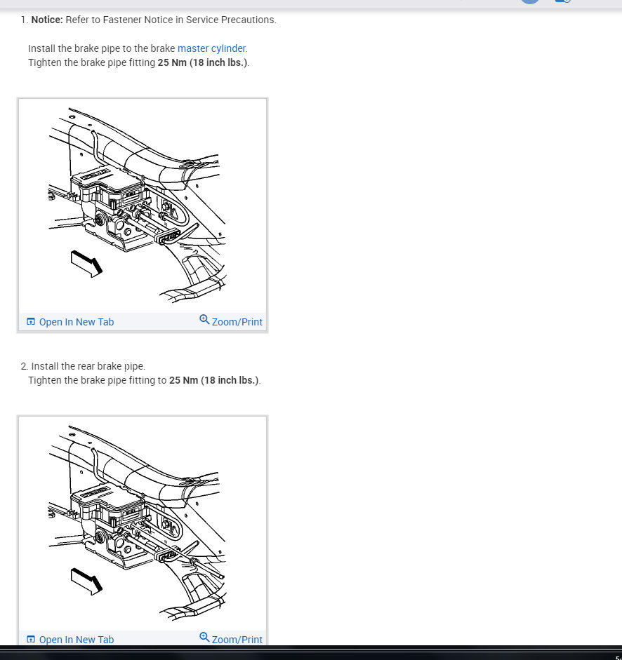

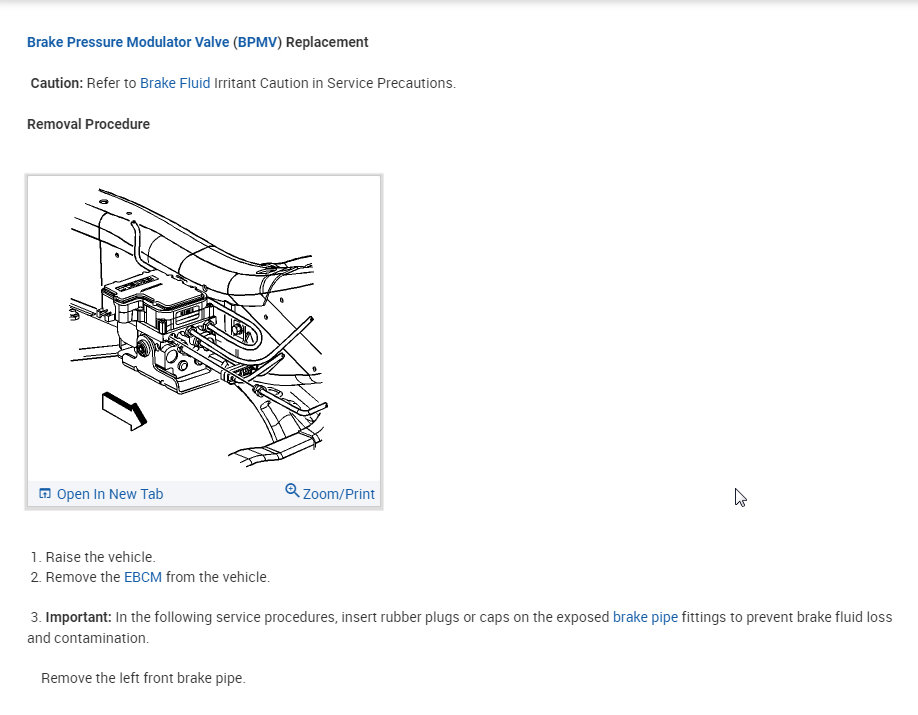

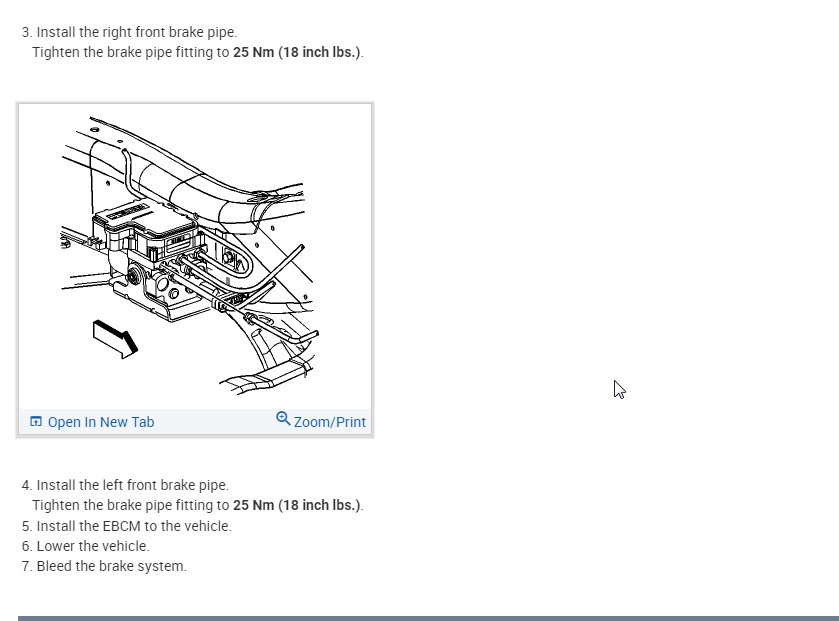

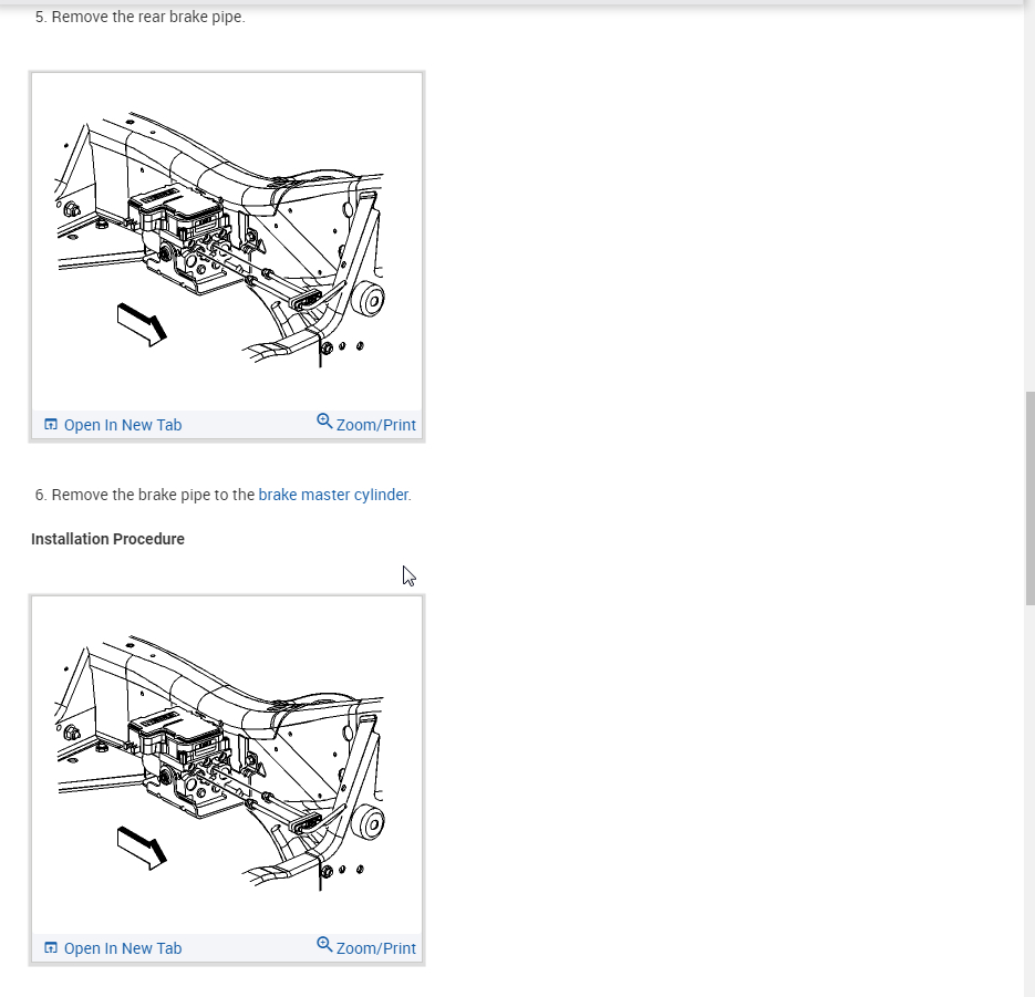

I think the issue may be is that it is not called the ABS module. On your vehicle it is called a Brake Pressure Modulator Valve BPMV and it is located on the frame rail. Here is video of the job being done on a similar car
https://youtu.be/lUotkKXG9dY
Here is the procedure on how to replace it. Let me know if you have more questions. Thanks
