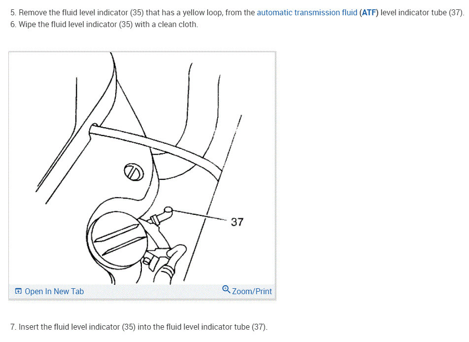

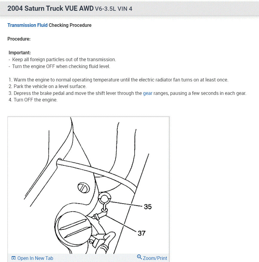

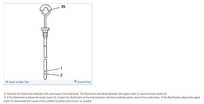

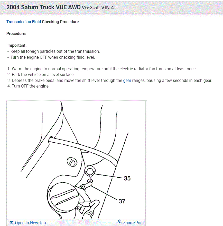

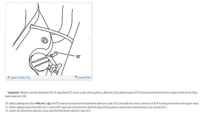

If you look down from the oil fill cap on the engine, you should see the dipstick for the transmission. It should have a yellow cover on its end.
I attached directions for checking below.
If your vehicle has a CVT transmission, let me know. However, I don't recall them being used on the 4wd models.
