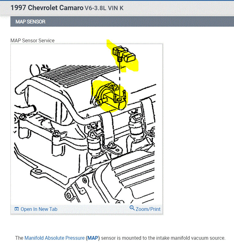

Where is the MAP sensor located?
1997 CHEVROLET CAMARO
158,000 MILES • 3.8L • V6 • AUTOMATIC
LCAB
Getting a lean code and thinking it's the MAP sensor. Check engine light blinks when I accelerate.

If the light flashes, it most likely has a misfire. If you are getting a lean mixture, the first things to check are fuel pressure and an engine vacuum leak. Here are two links that explain how to do it:
As far as the MAP, I attached a pic below showing it. Make sure the vacuum hoses are not damaged to it.
See pic below.
