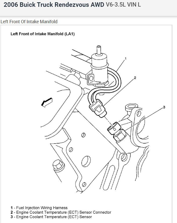

Temperature gauge is jumping all over the place.

Yes, the engine coolant temperature sensor is near the thermostat housing, here is the exact location. Check out the images (below). Let us know if you need anything else.
Image (Click to enlarge)
