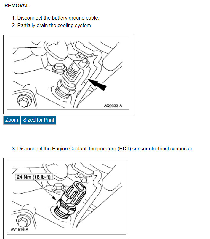

where is located the engine coolant temperature sensor on a windstar 2003?
Aug 27, 2014 at 12:36 PM
SATURNTECH9
  • 30,869 POSTS
On the front of the engine in the intake manifold , here is a generic guide to help you see what you are in for when doing the job step be step with instructions in the diagrams below to show you how on your car. https://www.2carpros.com/articles/coolant-temperature-sensor-cts-replacement https://www.2carpros.com/images/external/87562200.gif Check out the diagrams (Below) Please let us know if you need anything else to get the problem fixed.
