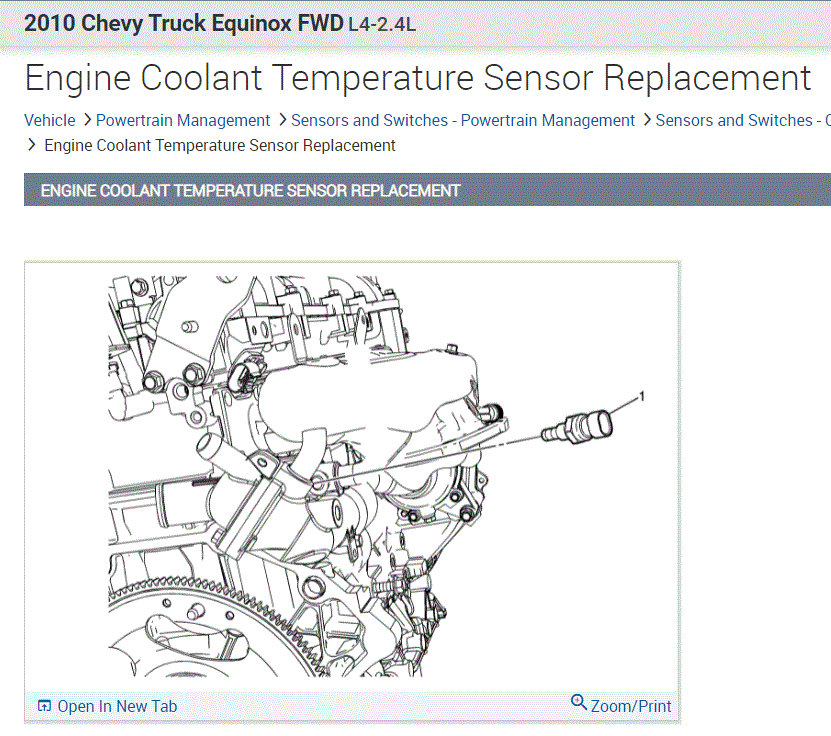

temperature gauge reads cold does not move. on dash it says A/C off due to engine temperature for 3 days. reservoir was at fill line now it's over fill line. car starts and drives. upper hose hot and reservoir hose hot.
Jun 17, 2021 at 6:18 AM
  • 110,248 POSTS
Chances are the temperature sensor is bad and therefore, the system, not knowing the temp, assumes it is overheating.
That is the first thing I suspect is the problem. However, make sure it isn't disconnected first and inspect the wiring to it as well as the connector.
If you determine it needs to be replaced, here is a link to help get you started:
https://www.2carpros.com/articles/coolant-temperature-sensor-cts-replacement

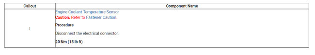

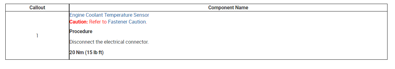

If you look at the attachments below, they are specific to your vehicle and the picture shows the location of the sensor.
