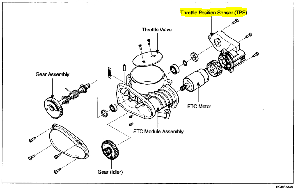

Loss of power bugging down. I replaced plugs coils even ignition coil assembly condenser capacitor. checked fuses got it started last, oh both cam sensors and crank sensor replaced .now fuel pump isn't working wtf else could ot be?
The vehicle listed above has a 3.3 l v6 engine.
Aug 15, 2023 at 4:02 PM
  • 110,194 POSTS

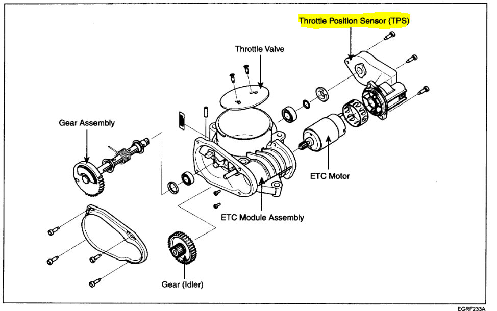

This vehicle uses the throttle position sensor to maintain engine idle speed. The TPS is controlled by the powertrain control module. (See pic below)
What is happening with the vehicle? Have you checked for diagnostic trouble codes?

See pic below.

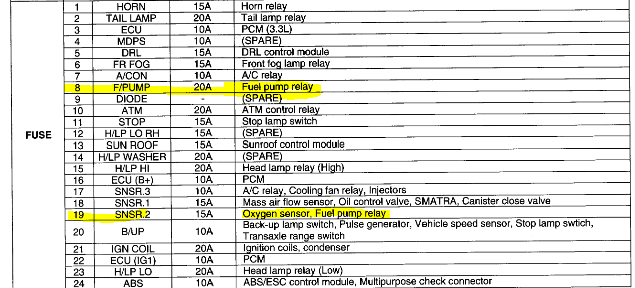

Yes, let me start by saying when scanned the first time it said 3 02 sensers were bad, waiting for those to come in. On my way home from all of a sudden the engine light started blinking then the misfire started. The car didn't want to accelerate. stopped, scanned it at auto parts store codes again 02 sensors followed by cam sensor a so replaced both cam sensors, also the crank sensor plugs and coils and even ignition coil condenser compassiter still would fire once then just turn over I I started to check fuses had to replace a blown fuse did that car started but still ran rough bit won't start and now I need a fuel pump but if there was a fuel pump in ot it push gas pedal down motor boggs down.

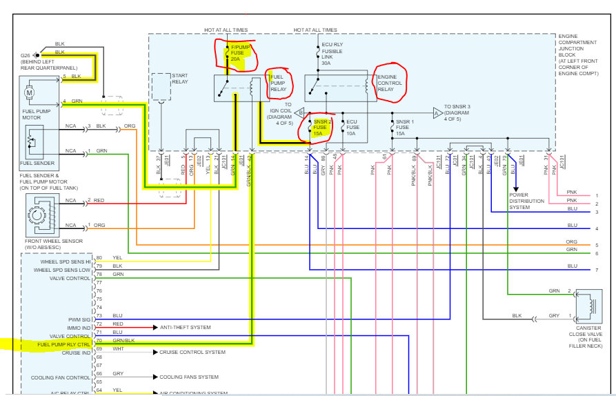

Looking back at your post, we know the fuel pump isn't working. So, we need to figure out why.

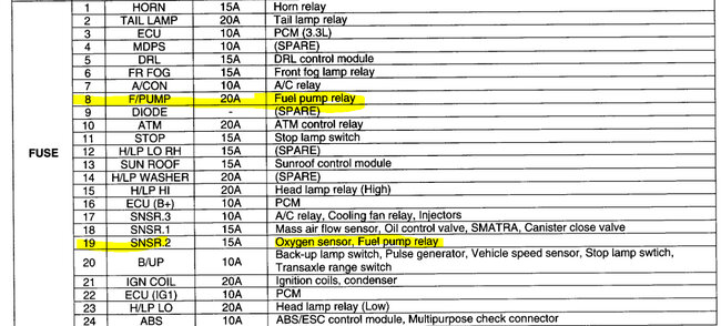

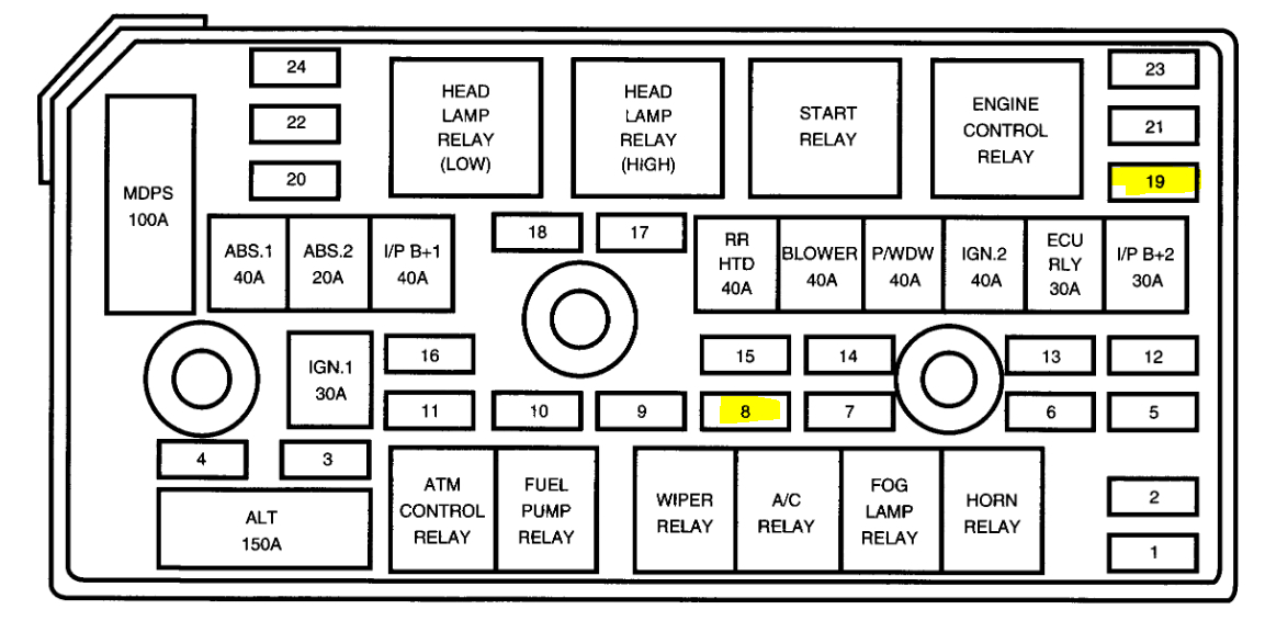

I attached the schematic below for the pump. I need you to check the fuel pump fuse and the "SNSR" fuse (sensor fuse which also powers the O2 sensors). You mentioned problems with them.
When you check the fuel pump fuse, make sure there is power to and from it. Also, when checking the SNSR fuse, the key must be in the run position.
Do this and let me know the results.
Aug 16, 2023 at 9:44 PM

Thank you, that helped. The fuel pump has power to it but not from it will actually fire everything I turn the key engine over but won't stay running. I have a question, could it be injectors that are bad or does this seem to be a fuel pump issue? As I said it fires tries to run if I pump the gas pedal it's like it tries to stay running but isn't getting the right amount of fuel.

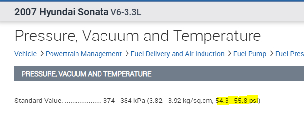

Chances are it is fuel pressure. At least, I would recommend testing pressure to see if it is within the manufacturer's specifications.
Here is a link that explains how it's done:
You will need a fuel pressure gauge, but most parts stores will lend one to you.
I attached the fuel pressure specifications below for you. Let me know if this is something you are comfortable performing.
See pic below.
