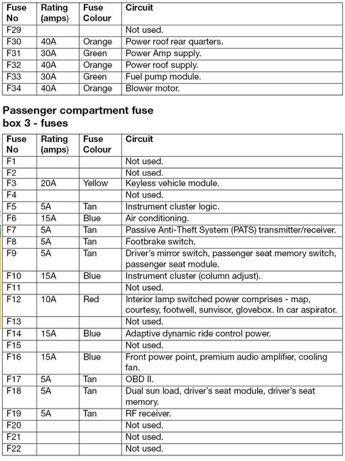

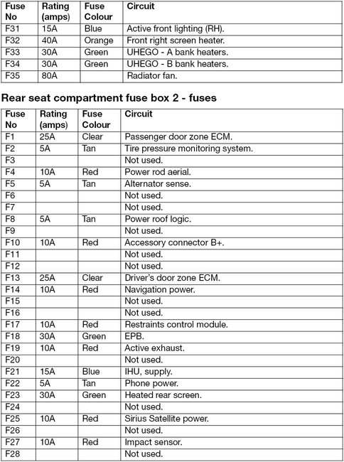

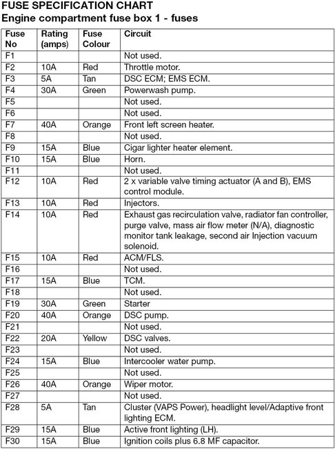

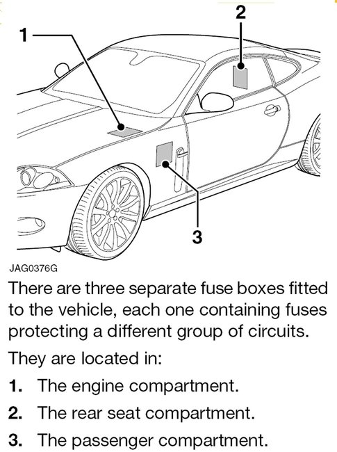

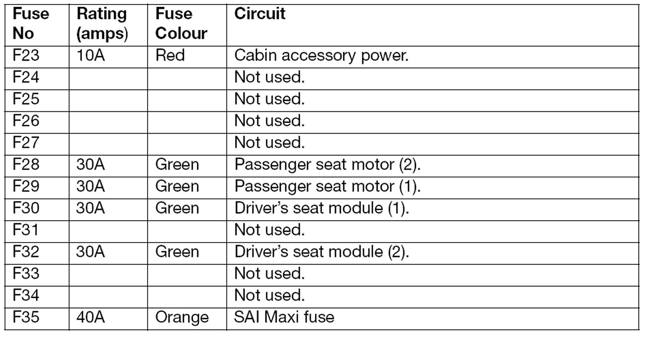

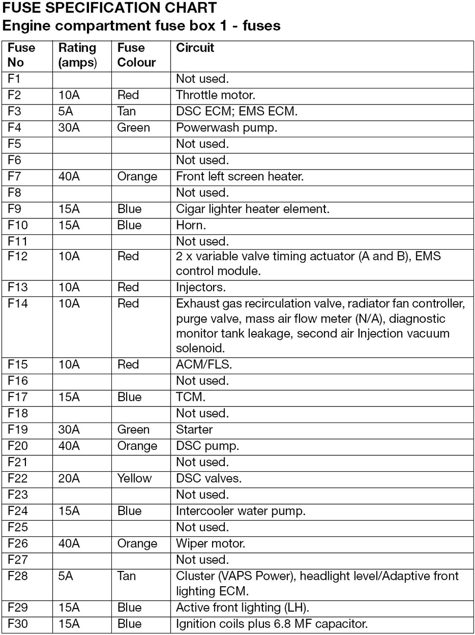

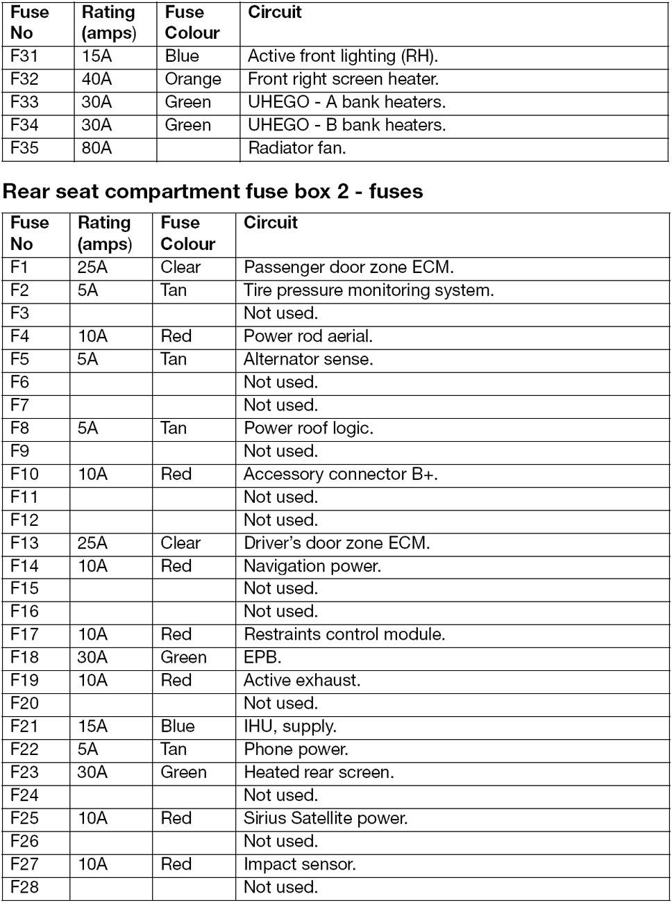

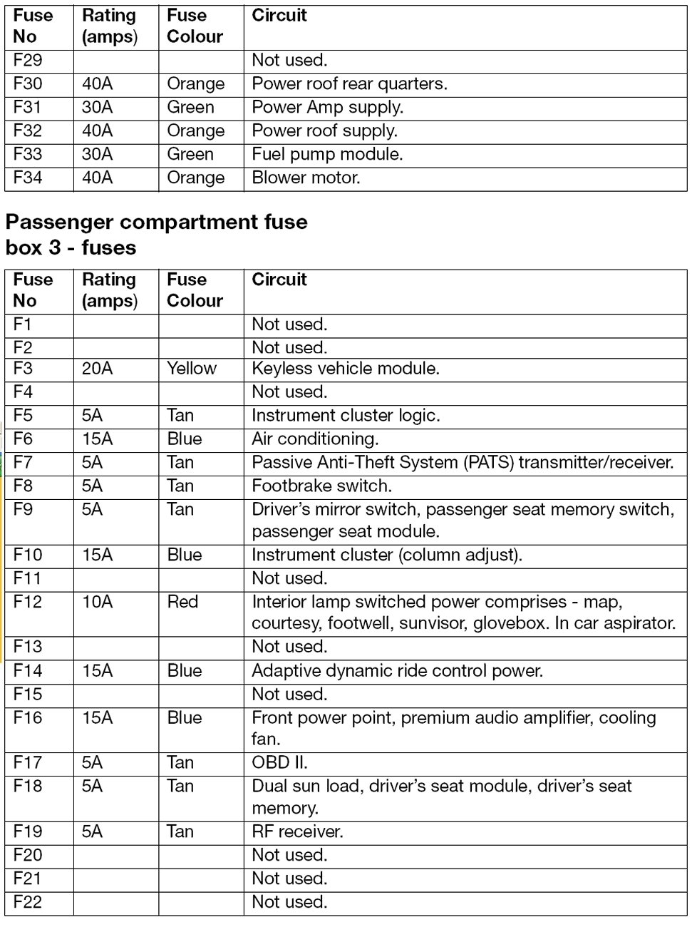

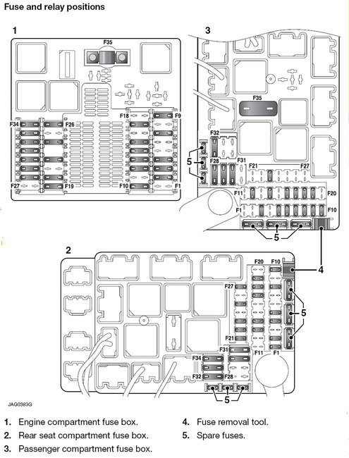

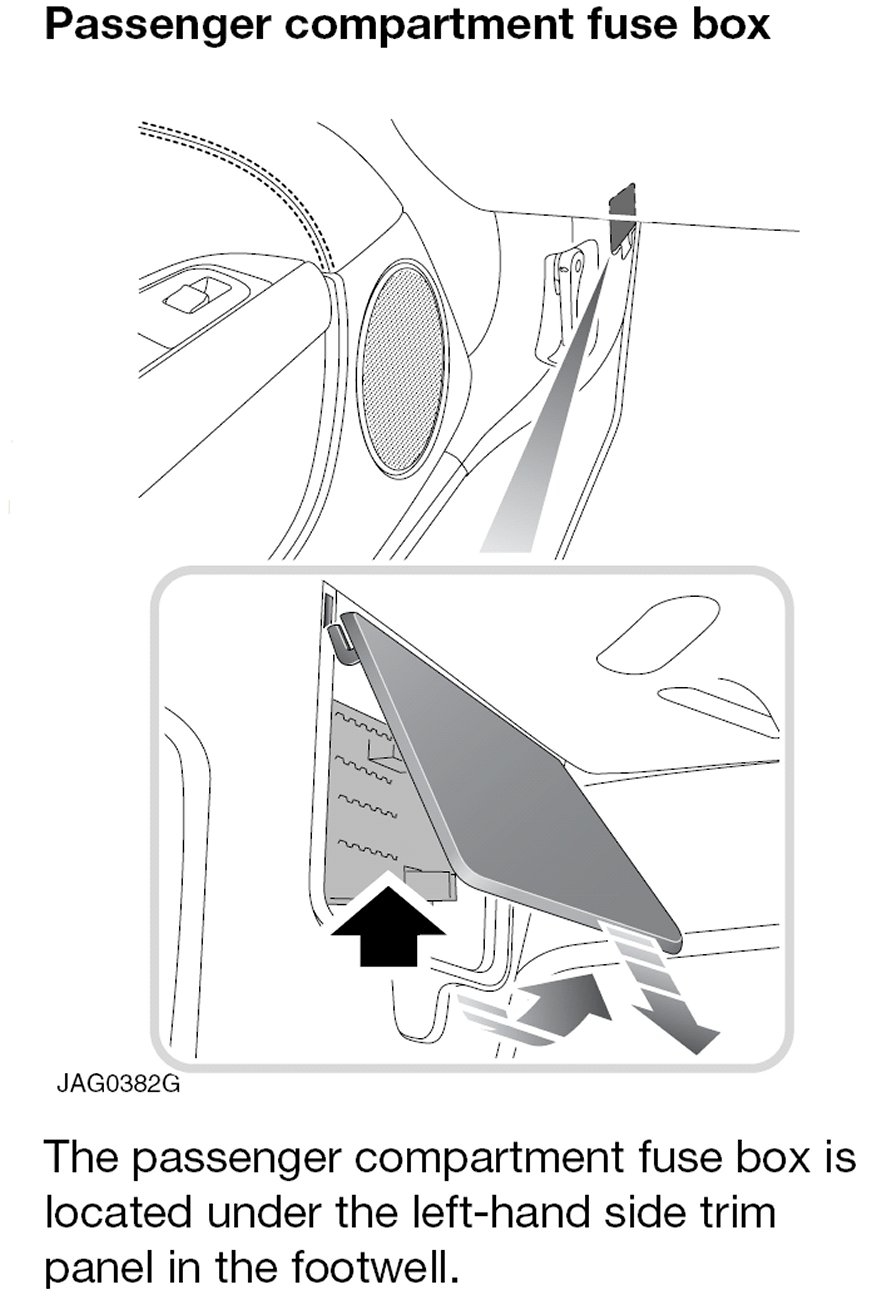

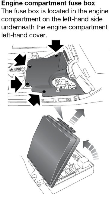

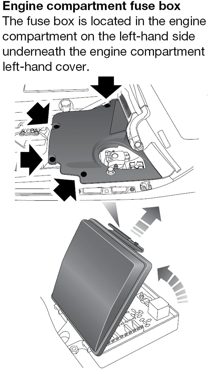

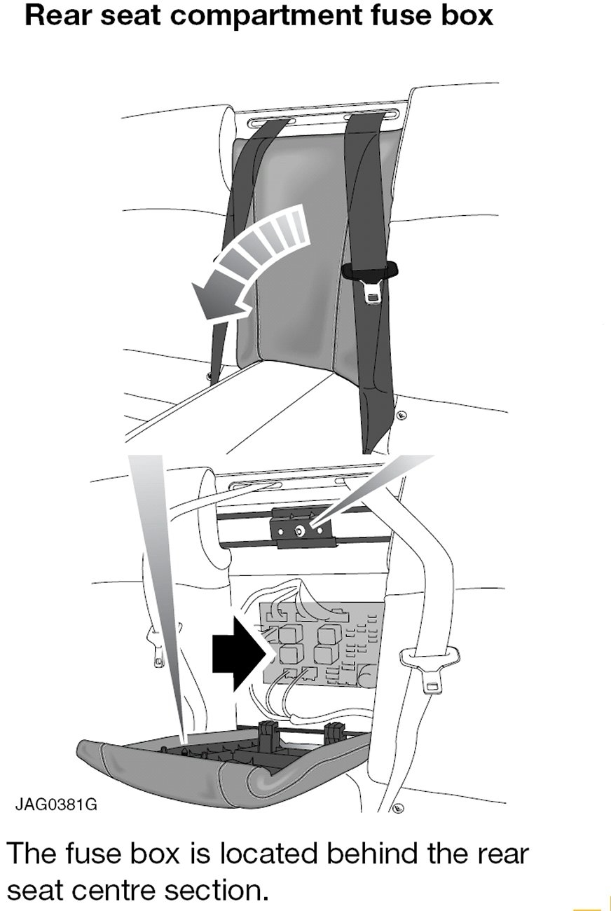

The A/C, defogger is not working.
Dec 9, 2018 at 6:44 PM
Experienced Mechanic
110,246 POSTS
Hi and thanks for using 2carpros.com
There are three locations. I attached everything related to fuses and the fuse boxs. Also, there is a legend that indicates what each fuse is for.
Let me know if this helps. Click to enlarge the images
