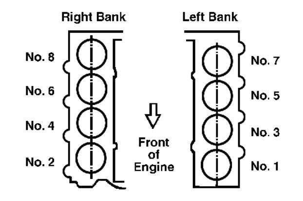

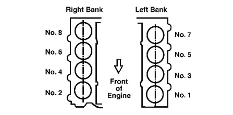

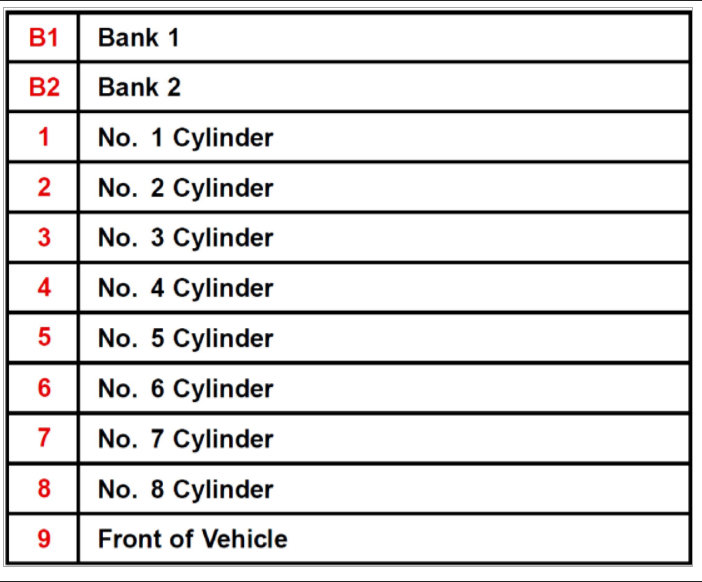

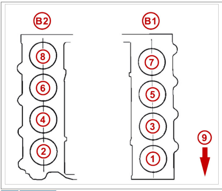

Where is cylinder number 2 located on the 4.7 l V8 engine? That will allow me to follow the exhaust to locate the oxygen bank 2 sensor 1 that I need to replace. Thank you!
Jan 13, 2021 at 9:20 AM (Merged)
KHLOW2008
  • 41,814 POSTS
Here is the engine spark plug firing order. Check out the diagrams (Below). Please let us know if you need anything else to get the problem fixed. Cheers
