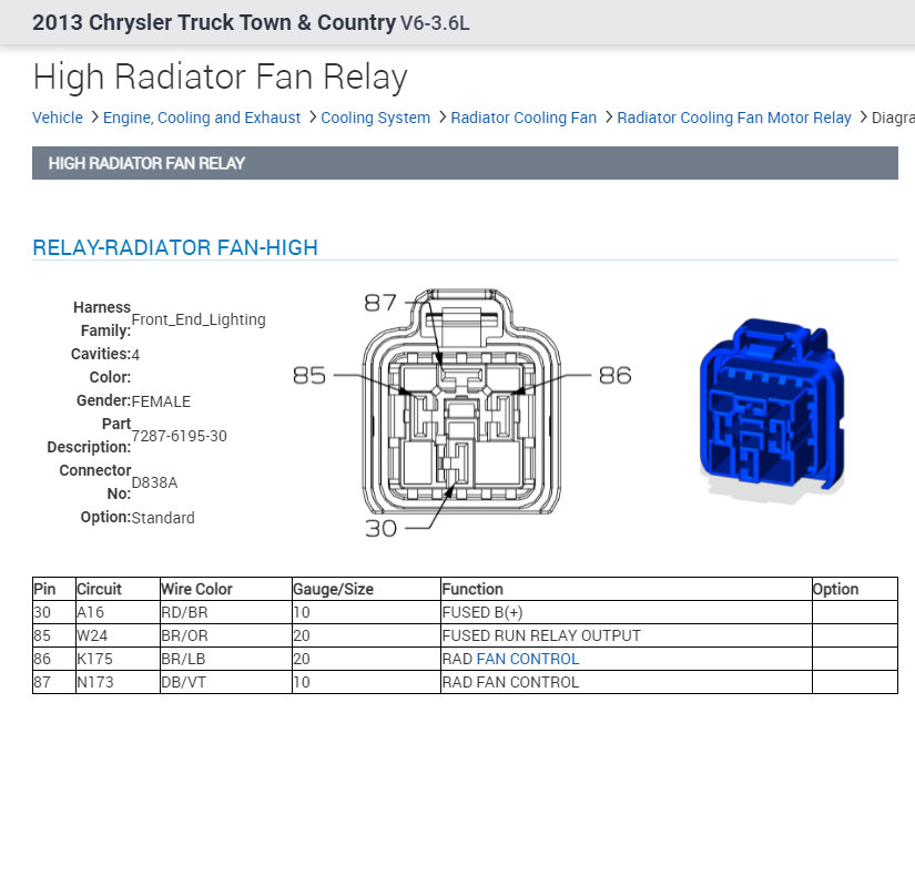

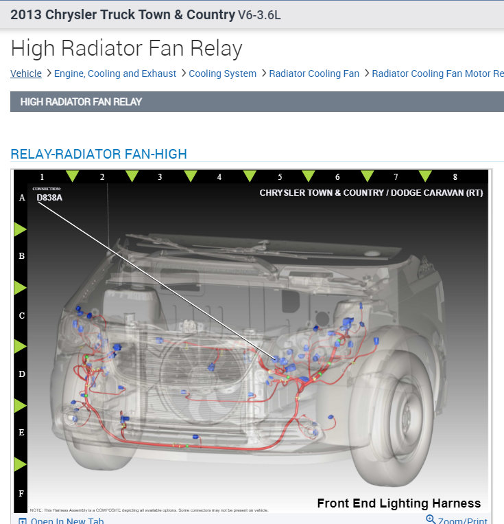

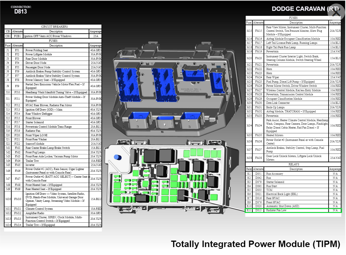

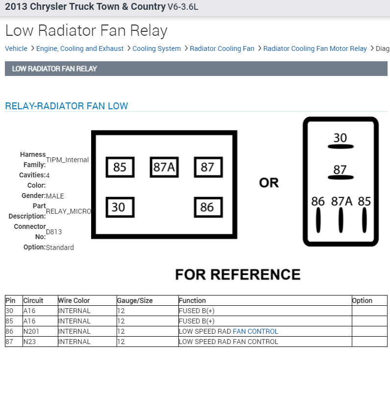

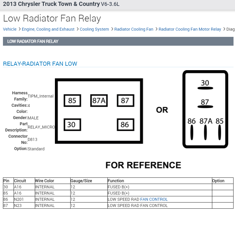

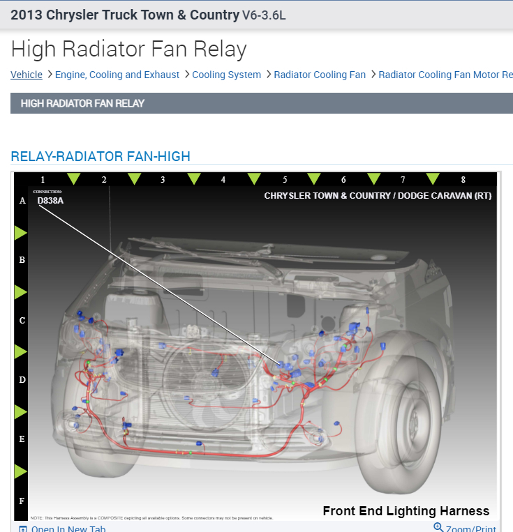

Cooling fans won't come on, can't find where the cooling fan relay is located.
Nov 26, 2021 at 1:05 AM
SQM
  • 6,383 POSTS
This vehicle has two relays for the cooling fan.
One of them in located in the fuse box under the hood, which is the low relay, and the high relay is located on the driver side next to the radiator.
Here is a helpful guide on how to test relays:
I have attached diagrams below.
