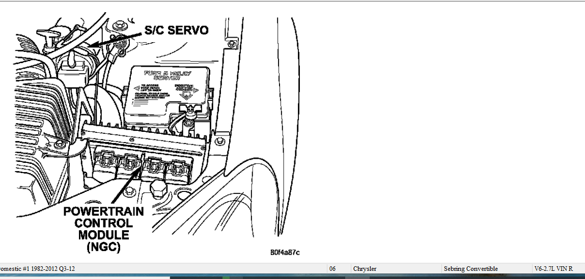

Where can I find the ECM on the car listed above Convertible Limited? I need to get the original ECM part number..

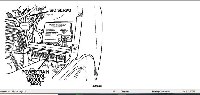

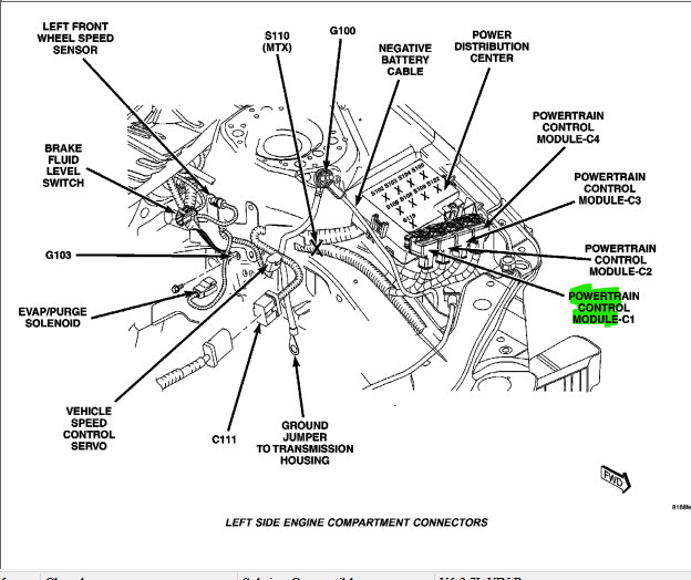

Engine control unit located driver side engine compartment, check the diagrams below.
Hope these helps.

Thank you! Those diagrams are different than ones I found. I was looking right at it but didn't know it was the PCM.

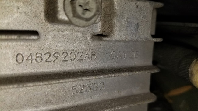

I do! Turns out, I can't find the number for the PCM so it can be replaced. Anyone know where it's supposed to be? The only number I located is part of the casting itself, which seems to be different than what is needed.

this number is the pcm part number 04829202ab of the picture that you attached. i will research to get your correct number.

your correct PCM number is 5094318AD price 470.00$
