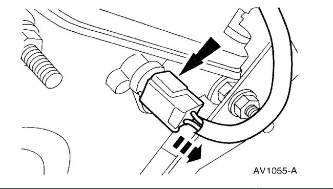

1,530,000 MILES • 5.4L • V8 • 2WD • AUTOMATIC
CODY AKINS
Vehicle dash cluster lights come on when you turn key over it tries to crank but and spins over once but never cranks. We have replaced starter. If we continue to keep trying to crank it. It will do nothing after as if battery has drained.
Nov 9, 2018 at 12:21 AM
Good afternoon.
The cam sensor is located below the valve cover. I attached a picture for you.
Do you have fuel pressure? Can you hear the pump run?
Do you have spark? Does the tachometer move up a little while cranking?
