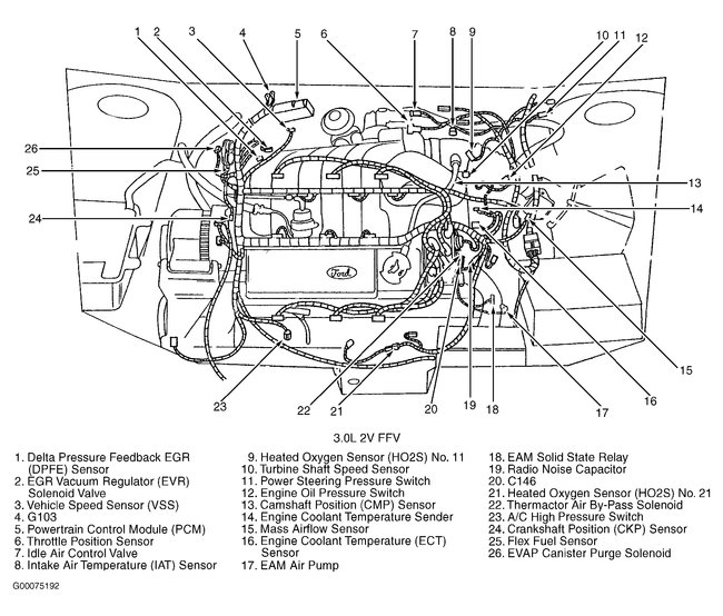

Check engine light on , code p1131.
Jun 29, 2016 at 11:26 AM
Experienced Mechanic
110,248 POSTS
Bank 1 is the one closest to the front of the vehicle. See attached.
