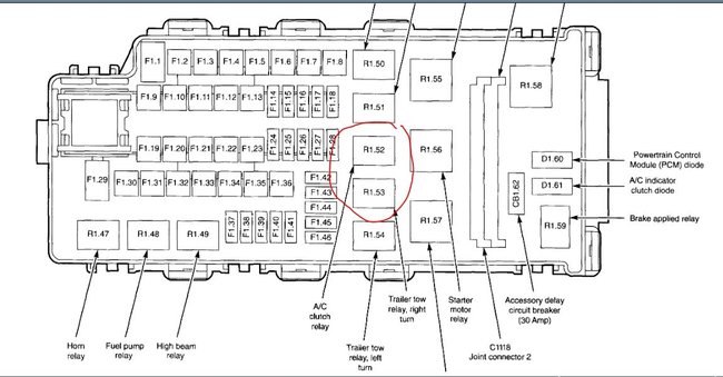

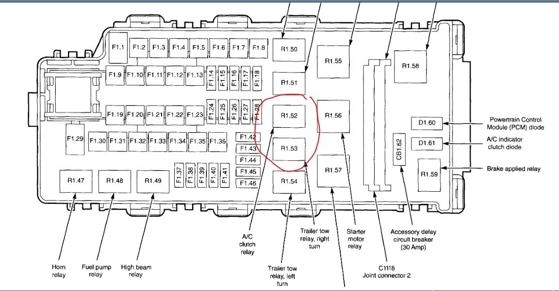

Where Is A/C relay and fuse
2003 LINCOLN AVIATOR
100,000 MILES • 0.5L • V8 • 4WD • AUTOMATIC
JJHS

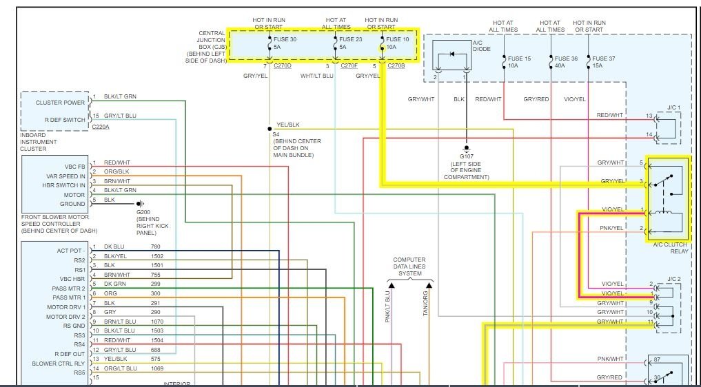

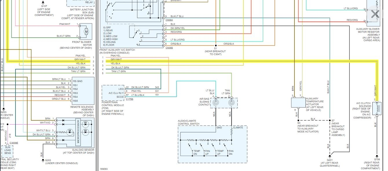

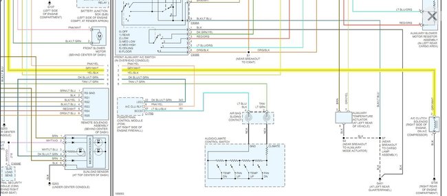

A/C blower is working but the Air compressor not. Gas pressure It’s okay.
Mar 12, 2020 at 5:14 AM
Good morning,
I attached a wiring diagram for you to view to check for voltages. Check out the diagrams (Below). Please let us know if you need anything else to get the problem fixed.
