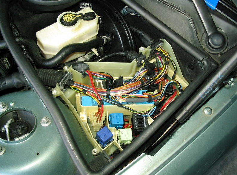

Trying to change out the transmission control module and having a hard time actually finding where it goes.

The TCM is located in the engine compartment in the windscreen scuttle next to the brake booster/servo. See image below
A good video:
https://youtu.be/kfpUKeHH6ak
Please note that the replacement TCM needs to be programmed to the vehicle using specialist diagnostic equipment.
Cheers, Boris
