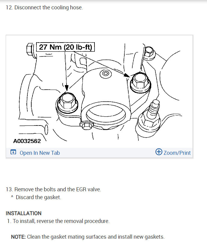

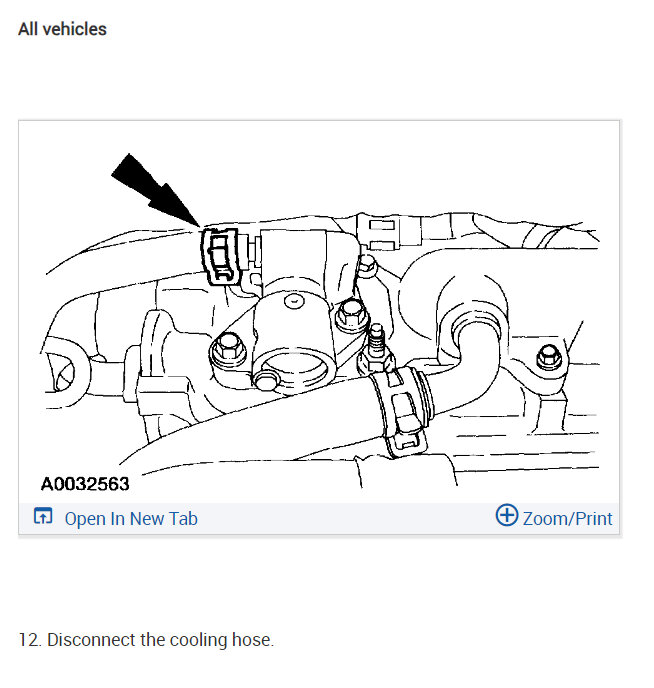

Where does this coolant line connect to?
2002 FORD RANGER
10,000 MILES • 2.3L • 3 CYL • 2WD • AUTOMATIC
RAY337
EGR valve coolant line connect to?
Aug 5, 2024 at 7:27 AM
  • 110,244 POSTS

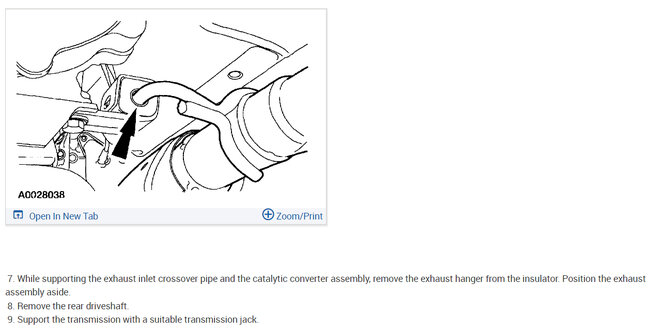

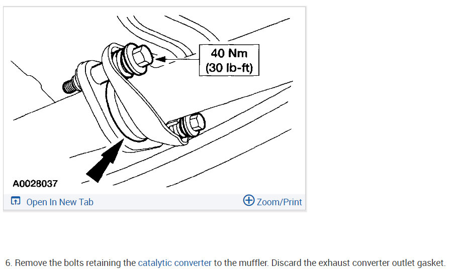

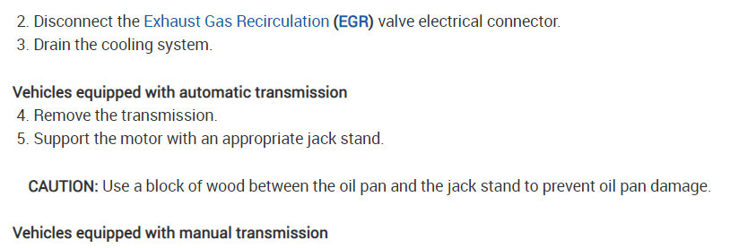

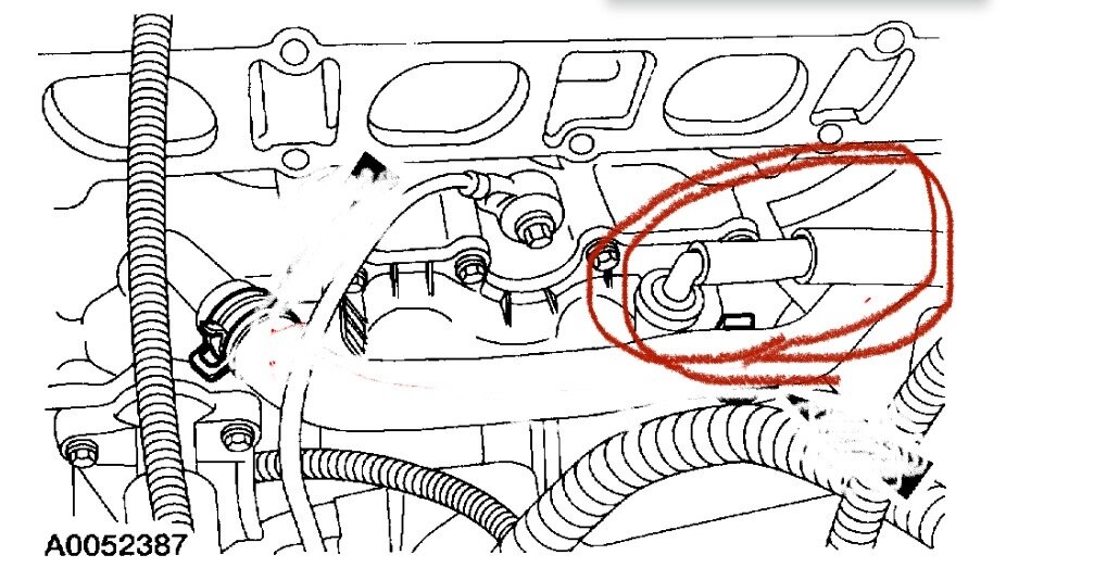

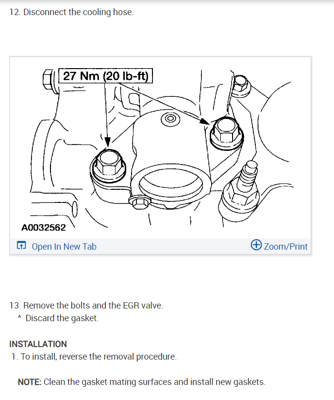

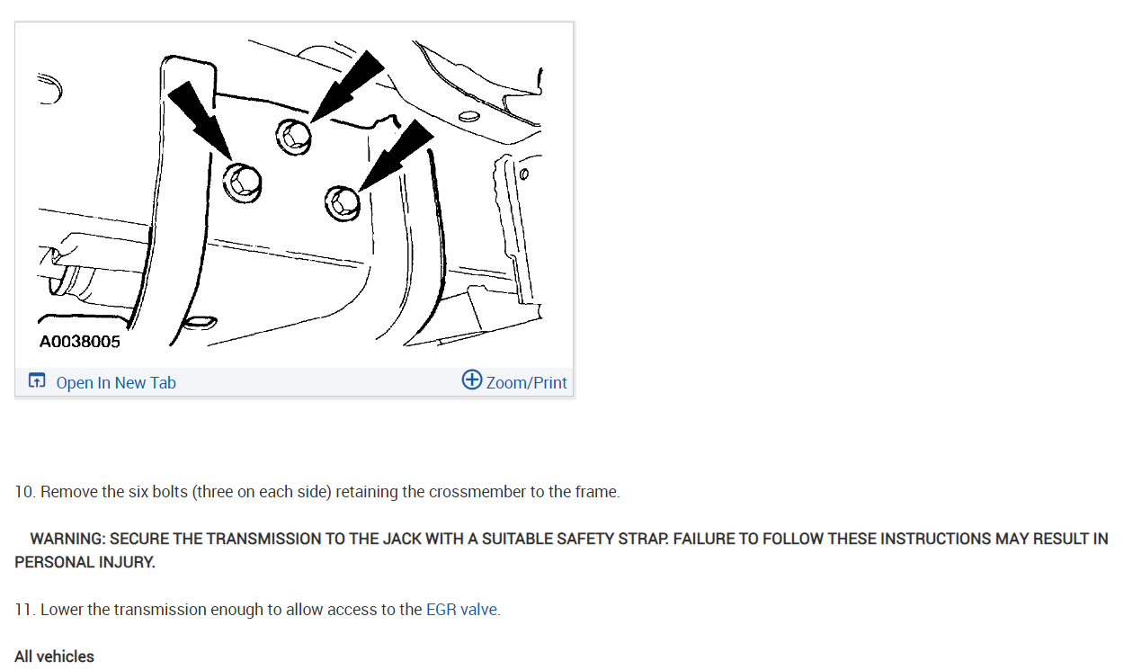

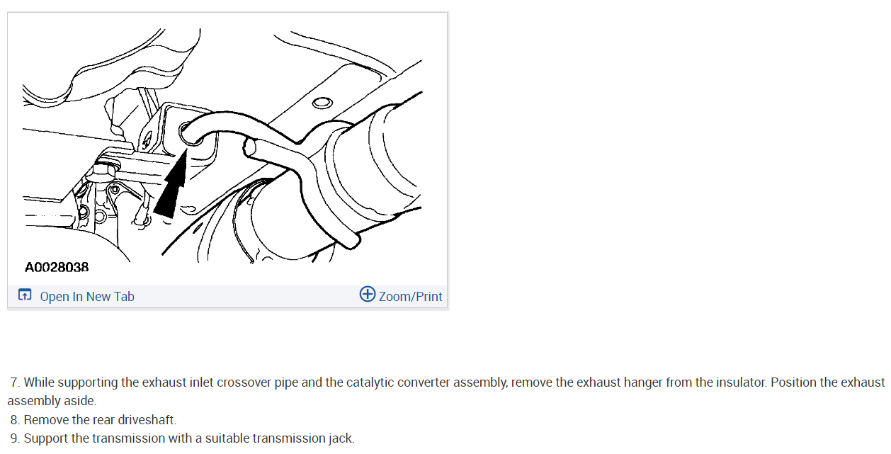

I believe that hose runs under the intake manifold. Take a look at the two pics I attached below and let me know if you are able to locate the connector.
Also, let me know if you have other questions.

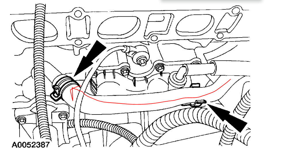

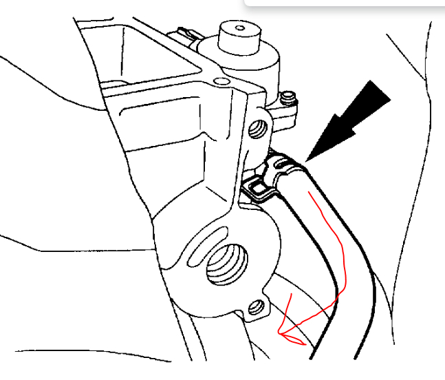

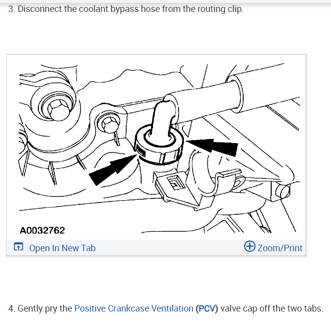

Trying to figure out where this hose goes to.

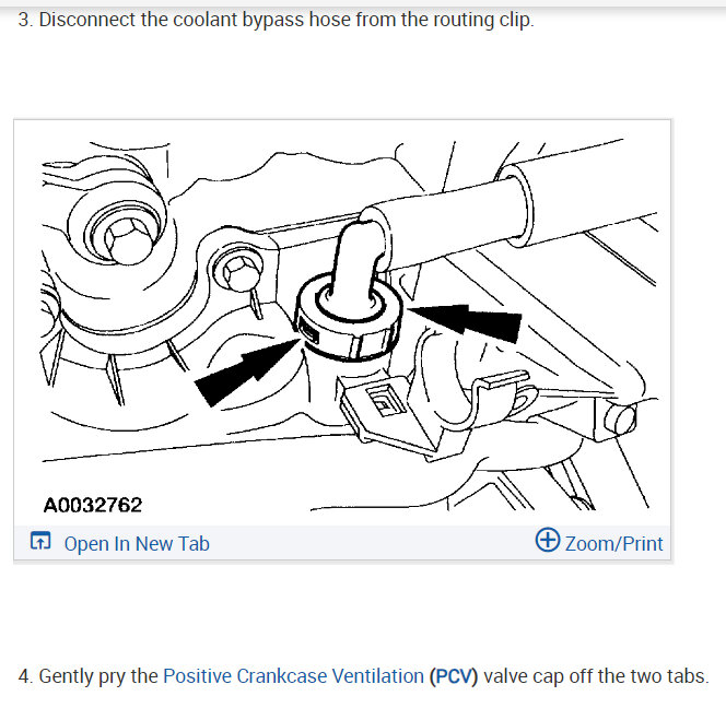

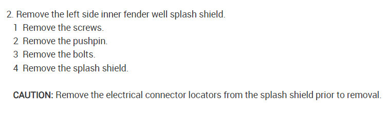

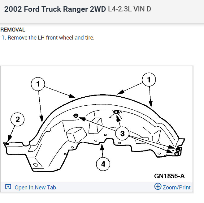

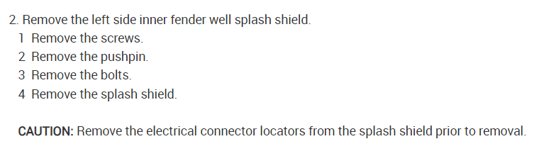

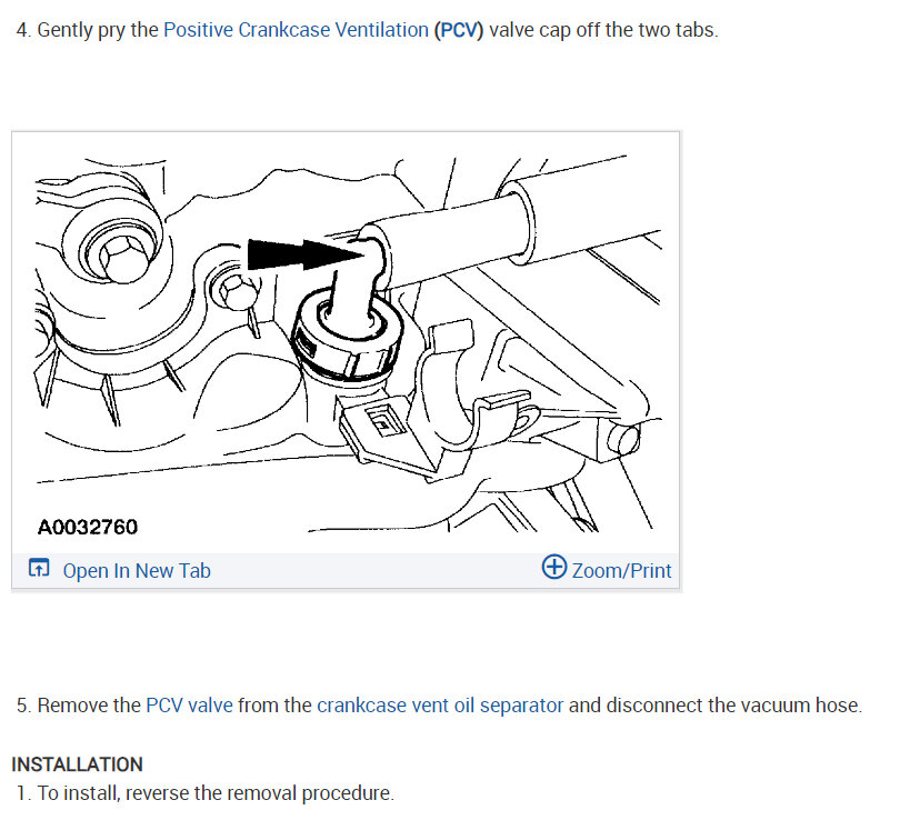

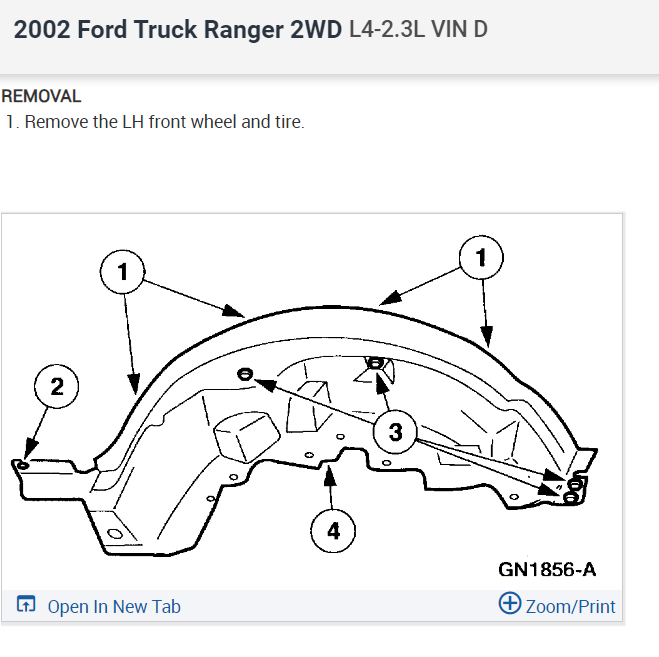

That looks like a PCV valve hose, it should go to main intake manifold vacuum. You will need to remove the inner fender liner to get at the hose and valve, here is the information we have for the vehicle.

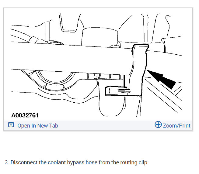

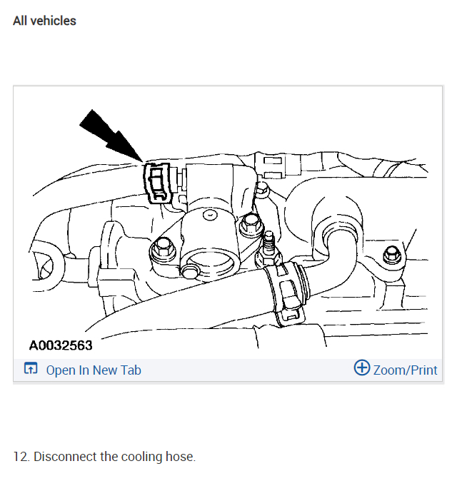

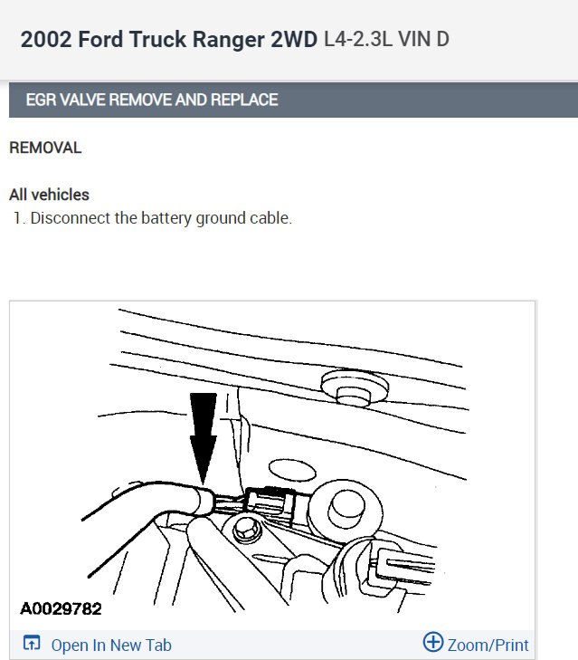

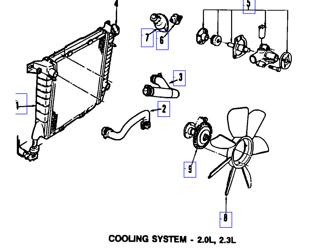

I am not sure what you need. If you can take an image and upload it, it will help. Here is the information on the cooling system and EGR valve I have so far. Check out the images (below). Please let us know what happens.
